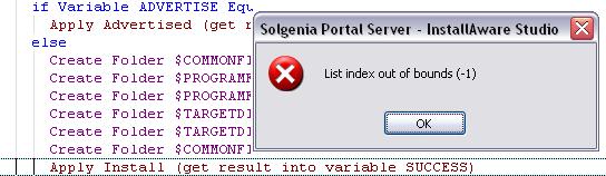

Looks like the project is corrupted in some way, look at this pic.
Try to delete or move the Apply install line
If I try to move or cut the Apply install line I get this error. I already had a look at the project script using Notepad but I cannot spot anything wrong.
How can I solve this? I do not really want to start from scratch!!!

It looks like these index out of bounds issues are often caused by script logic. It may be wise to break your script up into smaller scripts and make use of the Include Script command.
How bad is this inability to copy the Apply Install line? Can you insert some blank lines below it and paste to one of those?
Are you able to add an extra Apply Install earlier or later in the script?
Could you post your script for examination?

I did not try to add a new Apply install before, only change the existing ones (Apply advertise or uninstall), and this seems to have fixed the script in some way.
I do not know if this can help you understand the problem to fix it in the future
- I only changed the script using the IDE
- I was able to add empty (comment) lines above and below the Apply line
- when I added a new Apply Install line just above the existing one, the existing one disappeared (a misalignment between the .mia and .txt file?)
- my project is on a network share
Thanks again
