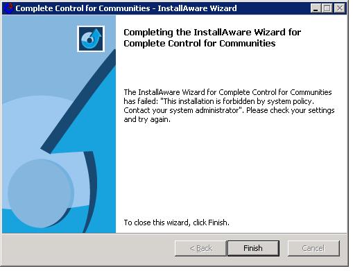

Run into another problem, it's download update, but when it try to install, it trow a message box (please take a look on attachment)
One's agan i am trying to update an application on virtual machine, log on as "User"
Can i do something with IS or it's a machine local policies?

If you're on one of the newer Windows OS (Vista, 7), then it sounds like you're dealing with User Account Control. Although, the dialog does look like XP.
It does look like a system policy issue. You may need to package a single-file exe installer into a single MSI using the group policy wizard and issue the MSI to install through active directory group policy.

Andy, looks like RDC have nothing to to with ... i still getting same think on stand alone pc.
Also, after it fail, it still Write into Text File $EXEDIR$\installedupdates.dat from Value $UPDATE_NAME$ (at end of file) ... and unless i delete update name from this file, i getting:
MessageBox: $TITLE$ Update, No updates are available for $TITLE$ at this time.$NEWLINE$$NEWLINE$Please check back again later.
What can i do?

but anytime i try to run a patch as a [user], i get system policy error.

I believe that this behavior is a result of your windows group policies; you should be able to permit/deny this behavior by changing your group policies. Please let me know if you have any further questions.
