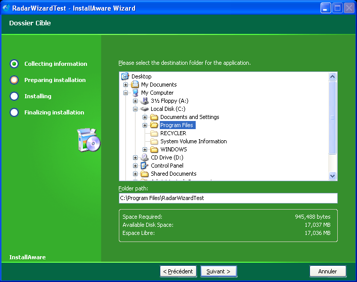

That's what I thought. any idea what could be causing the sort of behavior shown in the attached snapshot? It seems to have a strange mix of English and French on the dialogs.
- French language install on English XP
- FrenchInst.PNG (63.38 KiB) Viewed 7167 times

Yes. I used the wizard to export the strings, automatically perform the translation, and then re-import the strings. I just looked in the French translation file, and it contains the same mix of English and French that is displayed in the installer.

I am not using any custom dialogs, only the ones from InstallAware. The above screenshot was taken from the Emerald style of dialogs.
As an experiment, I created an empty installer using the wizard. I then localized the strings, and they seemed to all be translated. I then changed the theme to Emerald, and ran the localization steps again. This time I had the combination of English and French. When I get the chance, I'll try again starting out with the Emerald themed UI.

Again, only the Official dialog style would work - not any other dialog styles (including the emerald one). Right-click on Dialogs, Add Dialogs to Project, "Official" under the Add a Pre-Built, Themed Collection of Dialogs.
Re: A simple localization question
Now I understand. I misunderstood what you meant by Official. I thought this meant that only the dialogs from InstallAware were translatable.
