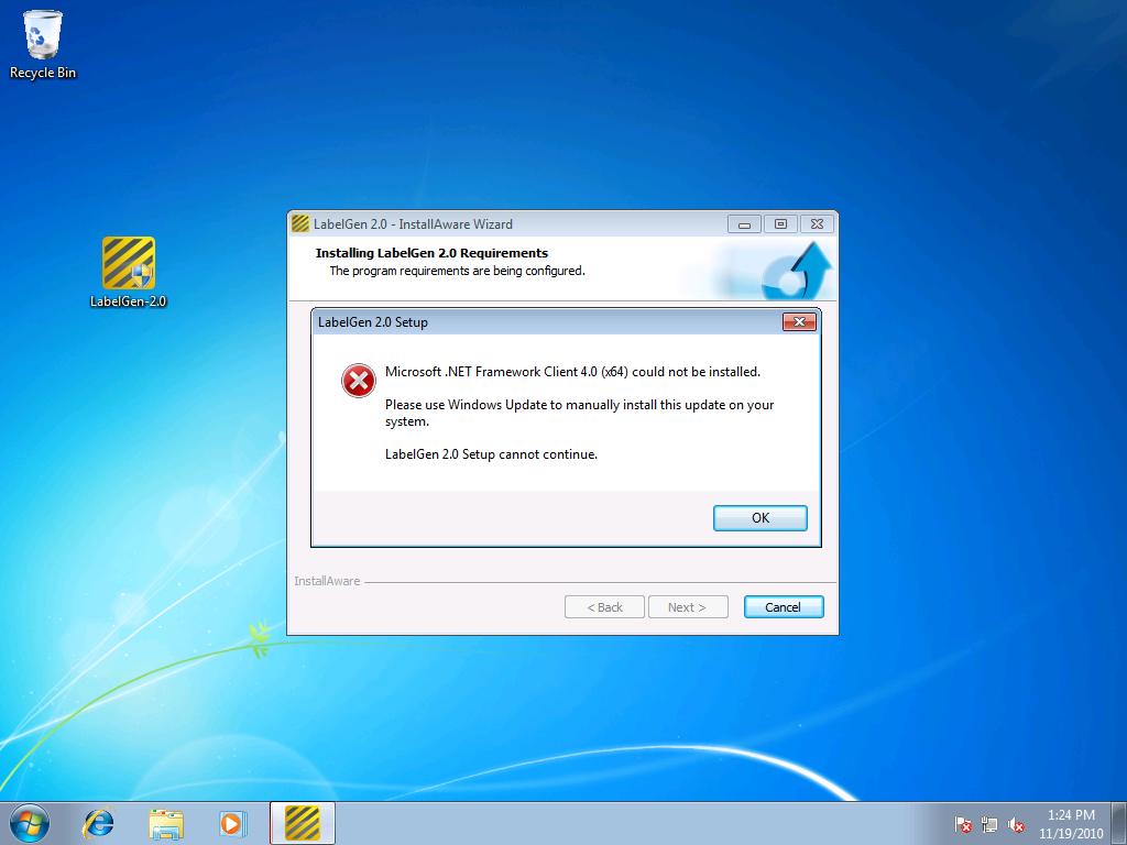

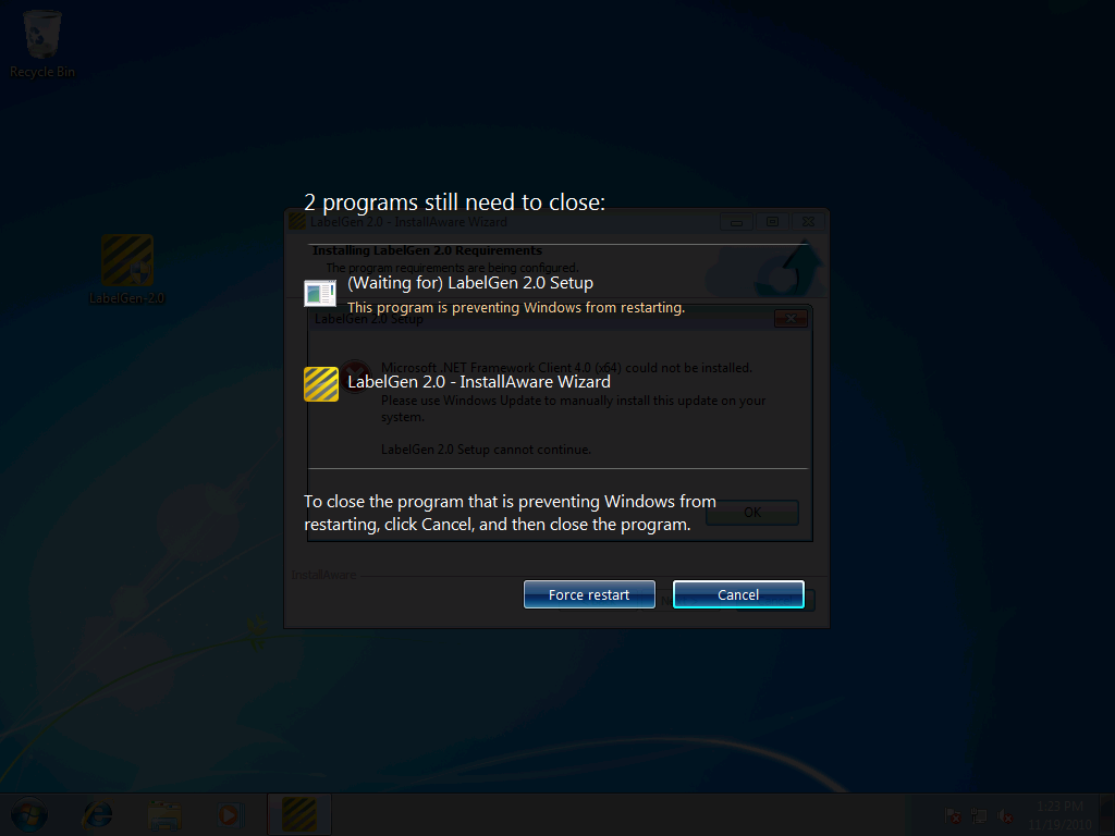

I have a installer made for a desktop application that use the Microsoft .NET Framework Client 4. The installer checks for of the OS is 32 or 64 bit and then install the Microsoft .NET Framework Client 4 if is not already installed.
This work OK with Windows XP and Windows Vista. But with Windows 7 both 32 and 64 bit the installation stops when hi seems to have installed Microsoft .NET Framework Client 4. It comes with a "Force Restart" dialog see attachment and if I close this the installer have a error dialog saying "Microsoft .NET Framework Client 4 (x64) could not be installed. Please use Windows update to install this update manual on your system."
If I then restart the system manual nothing happens, but if I then run my installer again hi install my software wit out problems and run it. Thus the Microsoft .NET Framework Client 4 was installed in the first attempt.
How can I solve this problem so that hi install in one attempt on Windows 7?
Force restart
Force restart

I think I understand you and what you are doing. But I'm not sure that's my problem.
It seems that some thing is trying restart the computer before the user have clicked OK in the dialog (see second images in my first post), I think this because that Windows comes with the black overlay/forced restart before I have clicked on the OK button in the dialog.
Do chose cancel by the force restart and the OK in the dialog hi restart the computer and gos further withe install after the restart - thus every thing works as expected.
Now the question is what tricks Window to come withe black overlay/force restart?

CFConnor probably mentions that, because if you try to install x86 runtimes on a x64 OS, you'll get the "must use windows update" message.
The simplest solution would be to use IA 10. It didn't display the darkened force restart screen when I built a test setup in IA 10, but did with IA 9.

I just had the same issue.
The solution is very simple: Just add /norestart to the parameters of the Run Program command in setupnet4_x86 and/or setupnet4_x64, so that the code will look like
   Run Program $DOTNET40_FILEBAG$\Setup /x86 /q /norestart (WAIT, get result into variable DOTNET40_RESULT)
That's all.
