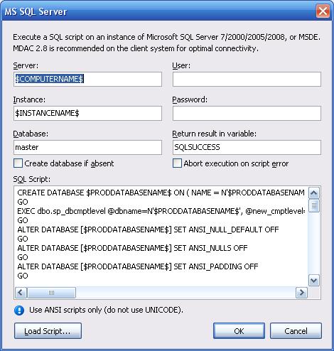

InstallAware does not like to run complex database creation scripts solely from the 'Server Configuration > SQL Databases > MS SQL Server > SQL Script' UI.
It seems that the 'SQL Script' frame in the 'MS SQL Server' UI is ONLY ABLE TO CREATE AN EMPTY DATABASE (...by this I mean a database that contains no Tables, Stored Proceedures, etc.)
So as long as the SQL database creation script that you paste into the UI (shown below) is designed only to create an empty database and log file, you will be successful.
Following is a screen capture of the 'MS SQL Server' UI settings from my project:
...and following is the complete script that is pasted into the 'SQL Script' dialog in order to create an empty SQL 2005 database:
As you probably guessed, the script above will not run successfully until you have defined the variables (PRODDATABASENAME, INSTANCENAME, COMPUTERNAME, etc.) within your InstallAware script. Following is an example of how and where you would define those variables after the 'Apply Install' area of the InstallAware script:

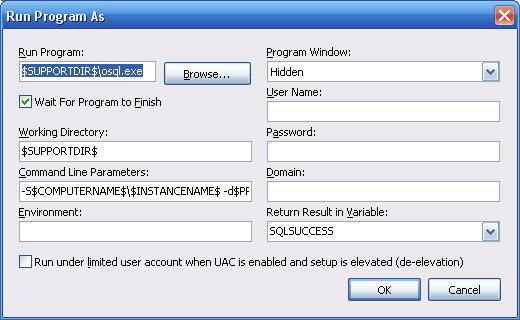

I took the remainder of my original SQL script (that part that creates the tables, etc) and I saved it as a separate SQL script file called 'mysqltables.sql'.
I then added 'mysqltables.sql' and Microsoft's 'osql.exe' (which you need in order to execute an SQL script file outside of Microsoft's 'SQL Management Studio') to InstallAware's 'Creatives' UI.
Please note that I have not included the content of my 'mysqltables.sql' script (that creates the tables and stored procedures) here because the database content requirements for your application will, of course, be very different than mine.
I then went to the MSI code section of installAware and added 'Alternate SQL Server' from the 'MSIcode' located in InstallAware's drag and drop area on the right side the screen. When you drag and drop this function into your InstallAware script, the following dialog box will appear:
I dragged and dropped the 'Alternate SQL Server' function into the code above where you see the line:
[Run Program $SUPPORTDIR$\osql.exe -S$COMPUTERNAME$\$INSTANCENAME$ -d$PRODDATABASENAME$ -E -i$SUPPORTDIR$\mysqltables.sql, startup in folder $SUPPORTDIR$ (WAIT, get result into variable SQLSUCCESS)].
So, if you have properly defined all of the variables and you have properly segregated your original SQL script into two separate scripts (one that creates the empty Db and one that creates the tables & sp's. etc), then you should have no difficulty getting InstallAware to create a fully functional database!
