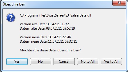

Why do I sometimes get a dialog where it asks me if I want to overwrite a file?
I created an update to an already existing installation and installed the new version on a test machine where an older version was already present.
I'm using IA11, native engine.
Thomas
Overwrite files Dialog
- OverwriteFiles.jpg (36.82 KiB) Viewed 2985 times

Hey Thomas,
Try setting the NATIVE_OVERWRITE variable to TRUE. Also, read about these variables in the help file:
NATIVE_OVERWRITE: Initially PROMPT. With the initial value, when setup is about to overwrite a file during a native engine installation, the end-user will be prompted with an overwrite dialog displaying the file dates and versions for both the new file and the old file, as well as the options to overwrite or skip the file. Set to ALWAYS to automatically overwrite files. Set to NEVER to automatically skip installing files that already exist on the target. Any other value will be interpreted as PROMPT. If the end-user makes the choice to apply the overwrite decision in the prompt dialog to all files, this variable will also be automatically updated, keeping the setup script aware of end-user choices and providing it with the ability to override them.
NATIVE_OVERWRITE_OLDER: Initially FALSE. Determines whether the native setup engine is allowed to replace files that have been determined to be newer with older files that are included in the installation. Set to TRUE to permit the native setup engine to replace files that are newer with older copies (this is not recommended). This variable overrides the value of the NATIVE_OVERWRITE variable when FALSE, and the file being installed by setup is determined to be older than the file already present on the target system. The native engine compares files as follows: If both files are versioned, the decision is based on the comparison of the file versions (the installed file has to be a newer version than the present file). If none of the files are versioned, the decision is based on the comparison of file dates (the installed file has to be modified more recently than the present file). If the file being installed lacks version information but the present file contains version information, the file being installed is assumed to be older. If the file being installed contains version information but the present file lacks version information, file dates are compared.
