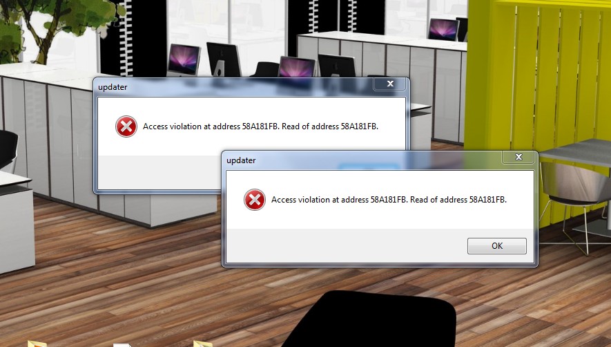

Attached an image with the error message.
Affected systems seems to be only Win 7 until now.
What can I do?
What can I do?
- ScreenHunter_01 Oct. 26 11.03.jpg (93.35 KiB) Viewed 12199 times

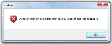

See attached error message, this window appears 3-5 times and then dissapears after klick on OK.
Again, I cannot debug this or do anything to resolve it, I just can rebuild setup and hope that it will work on ALL systems but always there are randomly few systems where it crashes.
- updater_av.png (53.06 KiB) Viewed 12091 times
