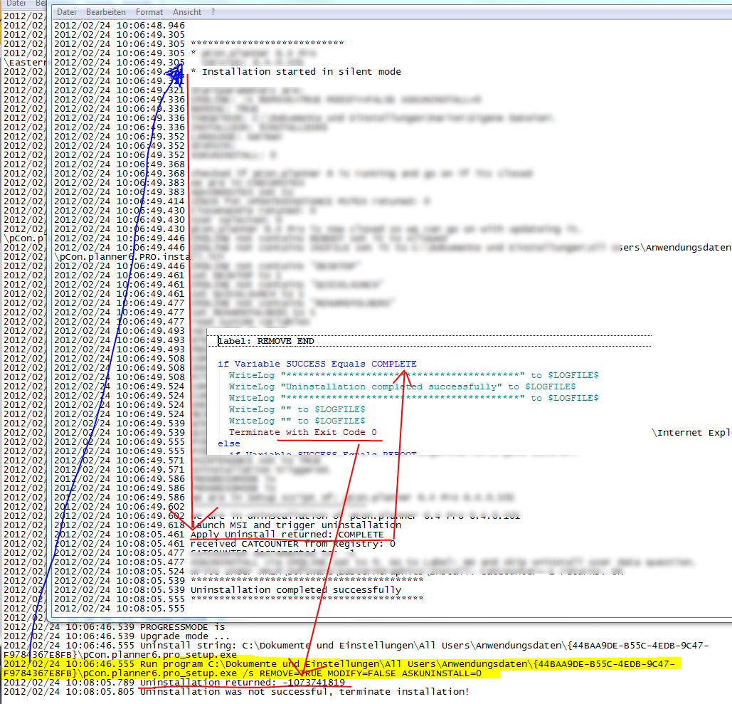

In my setup - as usual - the uninstallation is called if a previous version is found. Here is the application flow:
Setup is calling previous version uninstall
Uninstallation started
Apply uninstall returned: COMPLETE
(uninstall)Setup terminates with exit code 0
the calling setup receives a -1073741819
How could this be? Am I missing something, I have no idea how the setup could receive -1073741819 from a process that terminates with exit code 0.
For illustration I have attached the log files and a IA script snippet.
Hope someone can tell me what could be the reason for this.
Uninstallation returns 0 but setup receives -1073741819
- uninstall_returns_0.png (354.21 KiB) Viewed 3676 times
