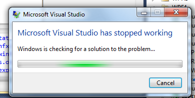

I have the same problem (VS2010 SP1 crashes instantly when editing C++ source after having installed InstallAware 10.10 Developer Trial).

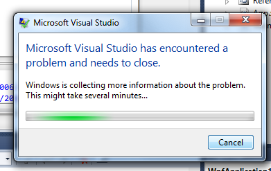

It appears that this issue is still present in InstallAware 2012. After installing the trial version, firing up Visual Studio 2010 results in a crash right after the project is loaded. This has got to be fixed. VS is my bread and butter. ;(
Sad I did not find this thread before installing. There should be a big warning when you install IA not to install the VS plugin (which actually is the reason I started looking at IA vs others...)
Update. If you open VS2010 with no project, nothing happens. However, the moment I create a new WPF project, I see

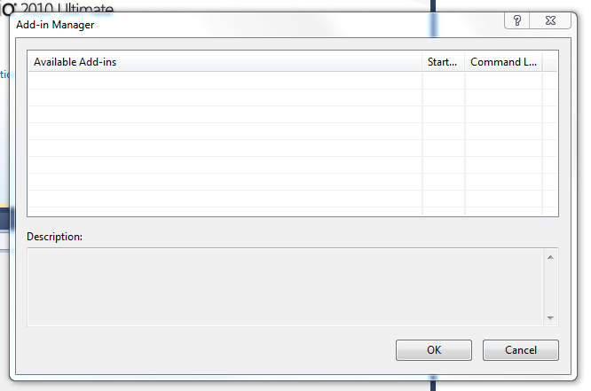

Going to Tools -> Add-in Manager, I do not see the IA add-in. How do I remove it?

Like others, re-installing InstallAware without the VS2010 add-on did not solve the problem. (In fact, another annoyance is that re-configuring the InstallAware install and unchecking VS2010 add-on does not do what you think - which is to uninstall the add-on, but actually re-installs everything else. 40 minutes of agony.)
I restarted VS2010. Same issues, this time without the InstallAware option in the menu. Debugging VS2010's crash led to this:
Attempted to read or write protected memory. This is often an indication that other memory is corrupt.
