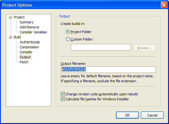

Actually, we use version number inside output EXE file name.
Just type the compiler variable name inside "Output filename" text field as shown in the screenshot (surrounded with #, that's to specify compiler variable), when building your project with miabuild don't forget to specify that compiler variable.
i.e. miabuild <youp_project_path> OUTPUTFILE=YourInstallerName_x.y.z.r.exe
the output file will be YourInstallerName_x.y.z.exe
where x.y.z.r - is major, minor, build, revision numbers
this is the way we use on our build machines.
P.S. For debugging purposes you can set a certain value inside IA designer, for example YourInstallerName_1.2.3.4.exe, but don't forget to disable it, before commiting the code into VCS. Specified compiler variables inside IA does overwrite the variables provided from misbuild. It would be a nice feature to be vice verse instead.
Hope this helps.

Posts: 3452
Re: Customizing Output .EXE name...
Post by MichaelNesmith »
Are you sure compiler variables inside the IDE actually overwrite values provided in miabuild.exe? It is the exact opposite according to documentation and my testing (which is the only sensible way, it would seem).
You can also set a compiler variable in your version field and make that same compiler variable part of the output file name. This way, you specify the version once, and that takes care of it in both places for you!
You just cannot refer to the existing version field through another "compiler variable". It is easy enough to just use a compiler variable in the version field and use the same value elsewhere instead.

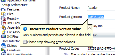

tofutim
Posts: 176
Post by tofutim »
Hi Michael, I wanted to use a variable for the version field per your suggestion but ran into this issue:
Can I safely ignore the tip?
Post by FrancescoT »
Dear tofutim,
you should not ignore that warning.
