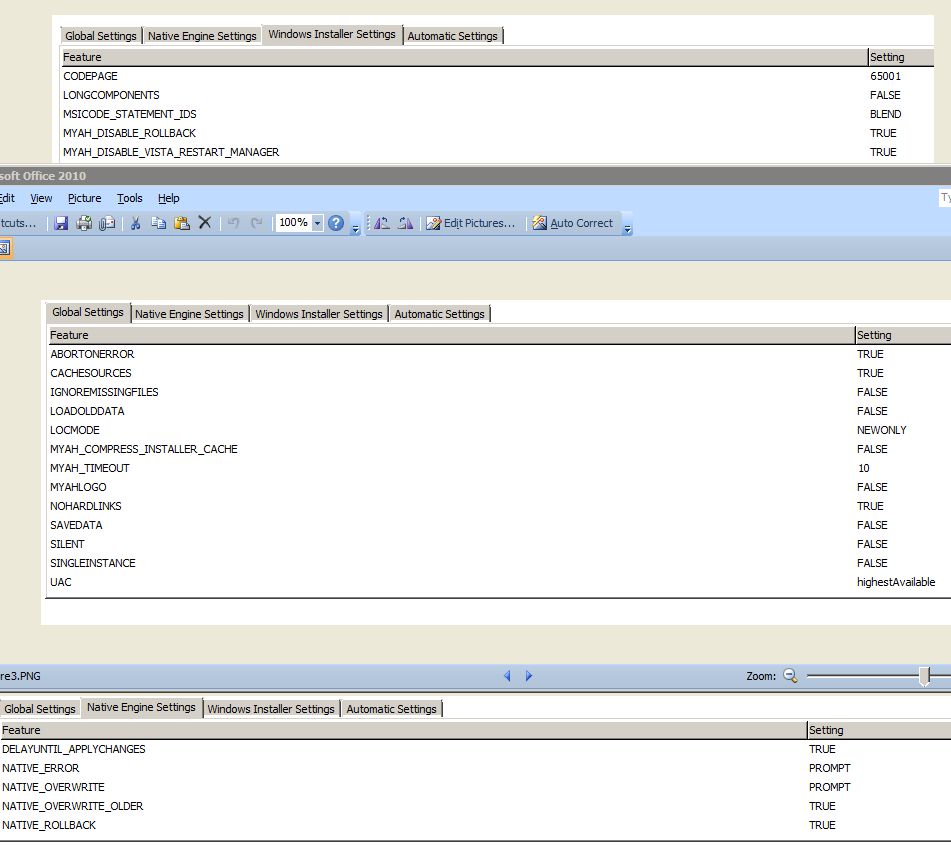

I have an installation which takes up 6 min to install. The software is 1.5gb (with 1426 files)
Most of the files are binary files.
Using installaware older tips
1) I have given the compression level to zero.(ie no compression)
2) I have also used MYAH_DISABLE_VISTA_RESTART_MANAGER: Initially FALSE. Indicates whether the Restart Manager on Windows Vista should be disabled. Set to TRUE to disable the Restart Manager and improve runtime performance;
Any other setup I can do to speed up ???
I want this to reduce to 2min.
Same setup with other installation tool is only 1.5min. I do not know why Installaware takes so much time and where. :cry:

I have attached the settings I have made.
I tried with Native installer and no MSI option, but the build did not execute. Anyways I am attaching the complete settings Which i Have made.
