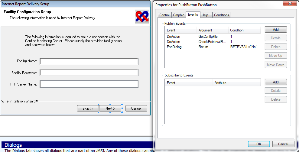

I have a WISE Installer project I am in the middle of converting and I have run into a snag. The old project has a custom dialog that has a list of actions executed under a button. Using the variable data from the dialog, it calls an executable to perform a communications test. It then call another executable to check the success of the for executable. Finally, it allows the installer to continue if the test was successful, otherwise user must correct their entries on the dialog and either 'Skip' the test, try again or Cancel. If the test was successful, it closes the dialog and the installer continues with the next line of WSIcode. Question: How can I duplicate this functionality in IA? I have included a screen shot of the dialog and the "Event" tab for the button.
- WISE Custom Dialog.PNG (57.02 KiB) Viewed 3498 times

Dear Chris,
If I haven't missed your question, I suppose the attached sample project can help you with the functionality you are searching for.
The sample uses a dialog with a custom button and then when it is selected, starts a Loop action via script with a call to "User32.dll"
- Basic dialog action.zip
