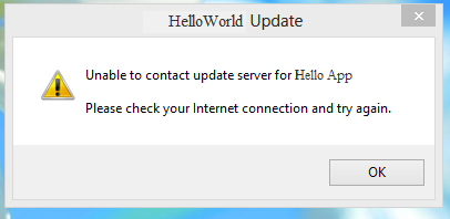

I am trying web update which can pull the updates form web( in my case a ftp site). To test it , I have selected the option "Manual Update Checking(start menu shortcut) and above that I have provided a ftp site as a monitor URL.
After installing the setup up file when I am trying the update form the shortcut start menu it says
"Unable to contact the Update sever for the <application name>
Please check your internet connection and try again"
I can access the ftp site and the respective folders in the browsers, but still install aware gives me that error.

I had tried with a Http site but still the issue remain same. Plase see the attached screen shot.

- This is through a http site, but still its can not find the update server.

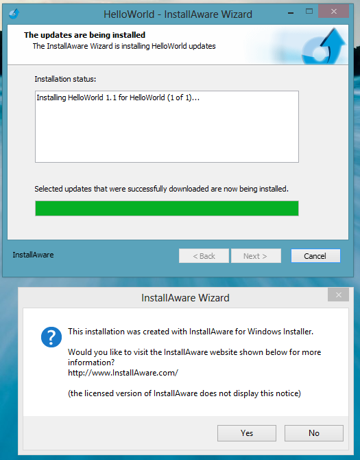

The auto update never works for me. I've tested it again today. Its always in the installation mode after being downloaded. Please see the attached screen shot to verify that. Am I missing anything in the setting? I have configure the following Setting Items.
1. Receive Application Update > Automatic Updates (Every time setup is run)
2. Setting Update packs and versions
Finally I have tried the Schedule Update and which also did not work for me. However, after the installation it did ask me the the scheduled day and time on the next reboot of the system. It never tried to download at all on the scheduled day. Let me know If I have to configure any other settings other than.
1. Receive Application Update > Schedule Updates (Every time setup is similar to windows update)
2. Setting Update packs and versions.
Let me tell you one more thing, I am using the same package that I sent you earlier for all the three type of update.
If you think there is some problem in the package then I wont agree with that for the simple reason as its working fine when I've used the manual update. Correct me if I'm wrong. And moreover as I said its installing nicely with manual installation.
