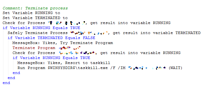

Hi Francesco, thanks for your prompt reply. Indeed, I started experimenting with Terminate Process - Check for Process seems to work fine, but when I try to Terminate Process, the result is FALSE. (This is "Safely Terminate Process.) I do have a .NET application running, and the installer is Administrator, and the running process is on the user's account. Is this why it doesn't work? Is there a way to force it to work?
Re: Shutdown running applications
Running taskkill does work. However it would be nice to "safely" terminate the program.
Francesco, in my scenario, Safely Terminate Process and Terminate Program always fail, only taskkill kills the program. Again this is a .NET program. Do I need something in my program to handle the messaging?

It turns out that if I set the Program Window Title Contains: to the exact window title, it does work. I was using a substring. Perhaps you mean "Program Window Title Is: (case sensitive, exact)". Once the program starts terminating, checking if it is running still shows that it is running (because the shutdown takes sometime). Is there an equivalent of Sleep so that I can check on a loop?

Dear tofutim,
unfortunately, doesn't exist a 100% safe way to forcibly kill an app and it also depends, on which is the current process state of that application.
In fact when this happens (I'm sure you've you have noticed it many times), the caller should inform the user about the termination and then to proceed accordingly.
Please excuse me, but it is not clear to me if the process that you want to kill is running under te same user context.
Anyway, taskkill will brutally terminate the process even if not the case.
Alternatively, but this requires some work on your application, you could send a specific message to the running application in order to handle the request to terminate. I am not a c# expert, but by the following link it seems to be possible in NET as well.
http://www.richardhyland.com/diary/2009 ... plication/
