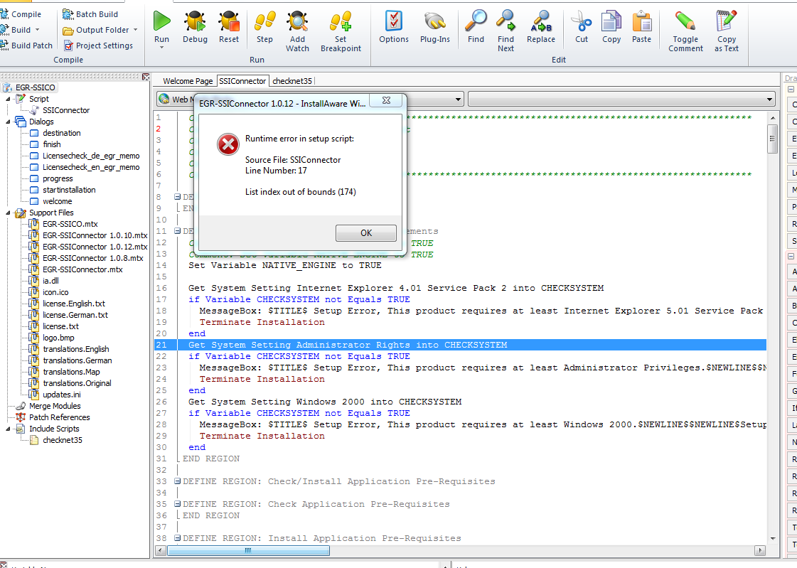

again a strange error where I have no idea what is the cause. I get "List index out of bounds (174)" error when I start an IA 16 generated setup. I have not changed anything in script, with IA 15 the setup was working fine.
I got this error also for line 12 at the beginng where the native engine is activated, so I copy and pasted this line again and commented it out. This was working but now I get this error for line 17 and here copy and past does not help...very strange
What to do now? Downgrad to IA 15?

Again I had to re-localize to solv this problem.

Dear Alibaba,
... if I haven't missed anything ... probably, it has been caused due the ANSI vs UNICODE resource strings, originally used by your project.
I am supposing this due the re-localization you used to solve the problem.

there are no UNICODE strings in line 17 so I don't understand why this is happening. Anyway this error is solved, but I still have other issues that block my work, see my other threads.

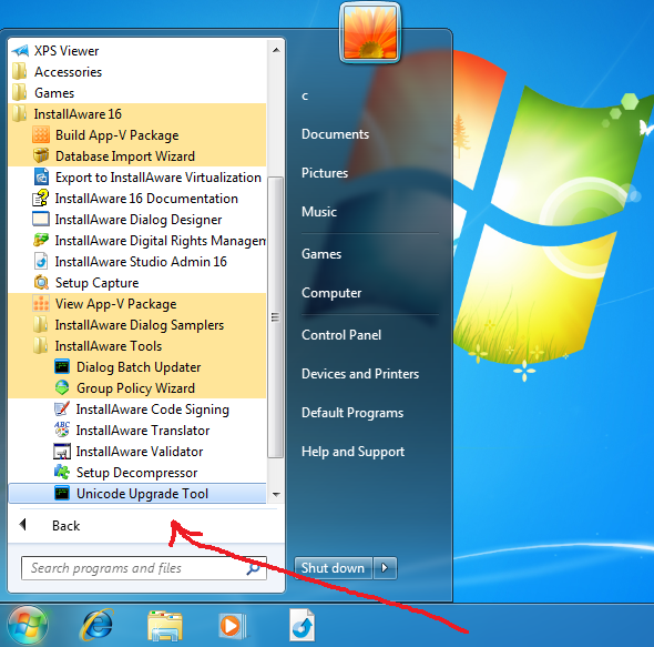

did you used the Unicode Upgrade tool?

Dear Martin,
RegardsUpgrading setups created in InstallAware 15 to InstallAware 16 is automatic, unless your setup contains localizations, or it contains hard-coded strings in your MSIcode script that are in a different language from your system locale for non-Unicode programs. If you qualify for the automatic upgrade process, simply open your project in the new IDE as before and continue working normally. If you must manually upgrade, run the new Unicode Upgrade Tool that is included with InstallAware 16. Then, you may open your project in the new IDE as before, and continue working normally.

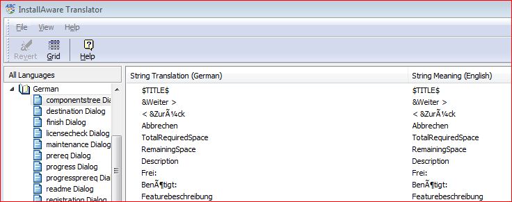

thanks for the fast answer. I did like you said and tried the Unicode Upgrade Tool. After that i startet my project with installAware 16 and the first thing i saw was all my characters in all messageboxes and dialog look like this:
After that i tried to export the translations with the Localize-Button. But there it doesnt look good at all...

I have just tried and by my test;
- if you re-localize your resource strings with preserving existing translations and then importing them back to the project, the localized strings are handled correctly (no garbage characters found). Of course if you prefer, you can completely replace any existing translation.
I have used a localized German language project and before to do the above operations, I used the Unicode Upgrade tool with specifying German as project language.
I found the same "list index out of bounds" error if I don't re-localize the resource strings, but after project re-localization the generated build works fine at runtime.
However, I believe that you should correct manually the German Text you used with your script directly ( ...as with the MessageBox code you posted). Unfortunately the approach you originally used, it is not the most correct. You should have used localized string variables within the script.
