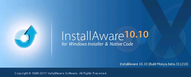

I am using "InstallAware 10.10" (Build Mooya.beta.311210) version
- Version.jpg (32.77 KiB) Viewed 11568 times

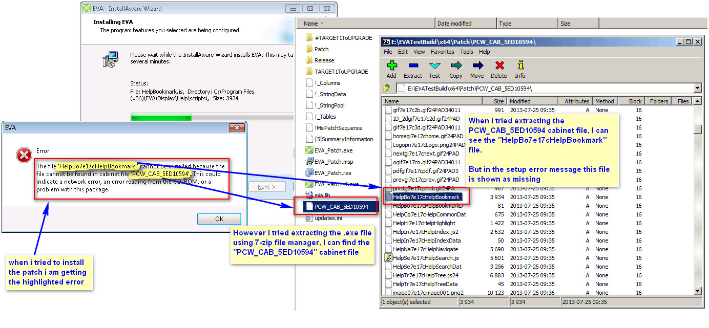

We are trying to give you more clarity on the previously discussing issue with patch creation.
We tried creating a patch for our silverlight application. However we created the patch in the same way you mentioned earlier.
While trying to install the patch we are facing an error in the cabinet file.
i.e the file 'HelpBo7e17cHelpBookmark' cannot be found in 'PCW_CAB_5ED10594' cabinet file.
But i tried to extract the setup file using 7-zip file manager and explored for the above file, all those files are present in the setup package. please find the screen print of those details.
Please provide us a solution or the reason for the patch fail.
- Patch_Issue.jpg (336.04 KiB) Viewed 11486 times
