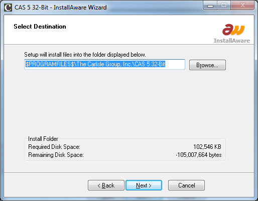

I am having the exact issue, $PROGRAMFILES$ is no getting assigned a value.
My MSI code looks like this.
  Set Variable TARGETDIR to $PROGRAMFILES$\$COMPANY$\$TITLE$
The runtime result is
example of untranslated var
Build:
IA2012 Moooya.9.26.11
I should also mention, the initial script was generated using the project wizard and I didn't modify any of the MSI directly. Doing a search in the MISCode doesn't show the $PROGRAMFILES$ being assigned anywhere.

I was able to use this as a workaround
  Get Folder Location System->Program Files Directory into PGFILES
  Set Variable TARGETDIR to $PGFILES$\$COMPANY$\$TITLE$
However, I'd like to understand why the otherway isn't working if it comes up with other variables.

Re: $PROGRAMFILES$ not assigned a value
Post by norbertjurkiewicz »
This was created from scrach using the wizard. I don't relaly want to start another one and go through all the cusomizations beacuse I almost have it where I need it. It looks like I'm having issues with the "Get Folder Location" variables that should be predefined but are not. http://www.installaware.com/forum/viewt ... f=2&t=8744
Thank you.

tzachk
Posts: 171
Joined: Wed Jul 18, 2012 12:14 am
Post by tzachk »
Just a thought,
Did you make sure that you use $PROGRAMFILES$ after it was initialized?
If you opened the dialog before you initialized the parameter, you'll get $PROGRAMFILES$ instead of the actual path to Program Files.
