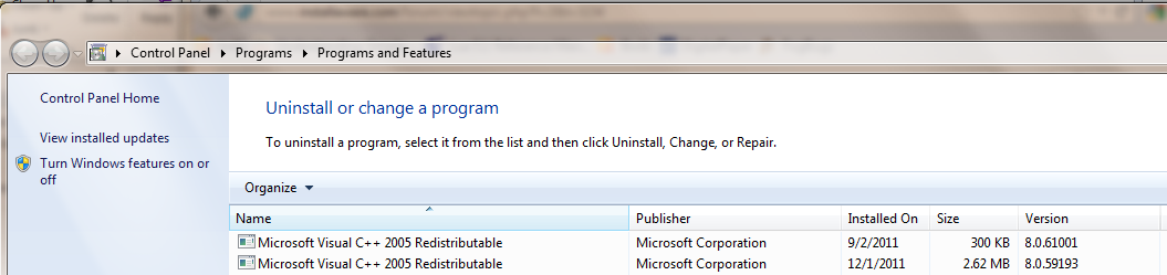

Dual keys in Add/Remote Programs
I've attached an image that argues otherwise. My Add/Remove Programs list has two of the same application name with two separate revisions/uninstallers. How can we do something similar?
Re: Add/Remove Program Entry
Post by FrancescoT »
In your screenshot you have the exact same application (that shares same files and installation codes) but two dfferent release versions and I suspect that it is generated by a patch installation of "Microsoft Redistributable. In Fact, the last one installed it is only 300 KB larger.
So in your case are not two applications that have the same name, but two versions of the same application, where the most recent entry it is an update.
In this particular case and following the Microsoft Installer documentation it is a "minor upgrade" Patch install.
Your intentions, if I have not missed anything, it is to have two different applications that have the same name ... that I quite think it is not possible.
