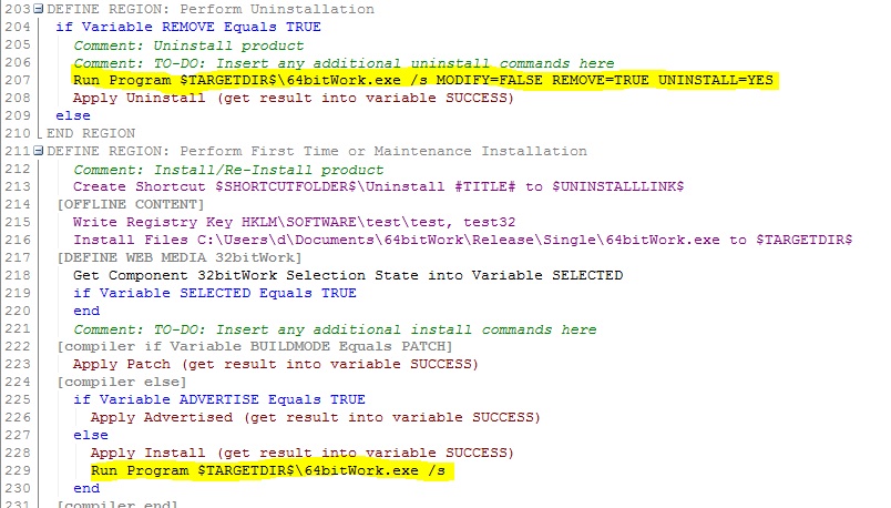

I ran a test, to see if two calls to Apply Uninstall would clear up the distinct bit-mode calls. It didn't work.
For the cleanest installation (and uninstall) of the 64bit and 32bit work, you'll need 2 installers.
I created one called 64bitWork. The first line I set to
Set x64 - Native 64 bit Windows, AMD64 and EM64T Architectures - installation mode
The only work it does is:
Write Registry Key HKLM\SOFTWARE\test\test, test64
Nothing else was changed.
I created a second installer called 32bitWork and added 64bitWork.exe as an installable file.
It writes an entry to registry (in wow6432Node) and also calls the 64bitWork installer.
Its code looks like this:
It's important to call the other installer after the apply install and before the apply uninstall
I verified both registry entries were properly installed and uninstalled when the 32bitWork (parent) installer was installed/uninstalled.
