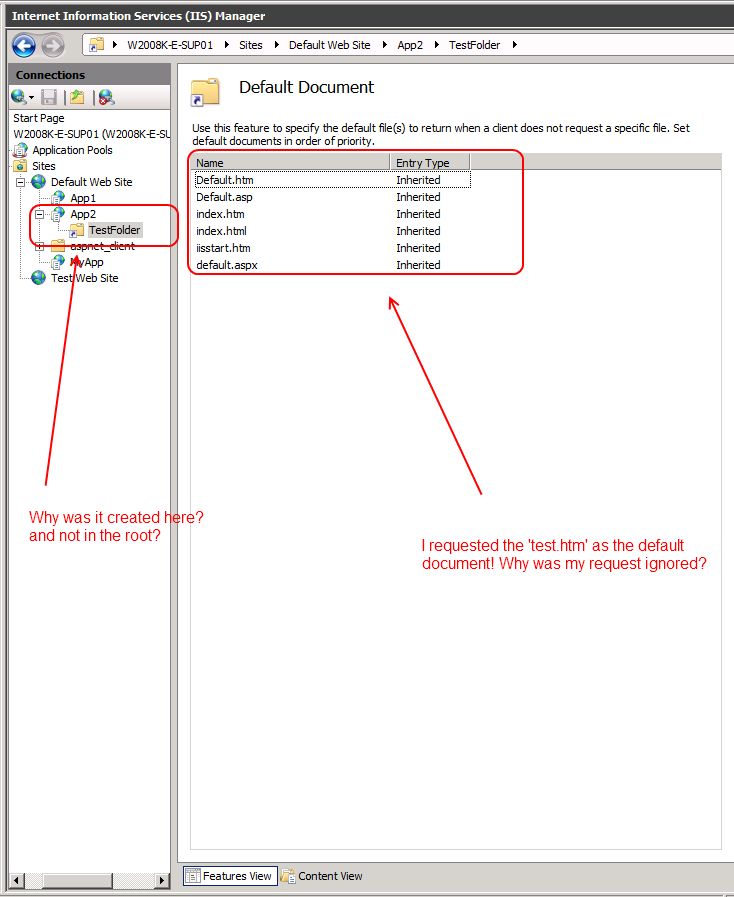

1. Possible BUG no 1: Cannot create a Virtual Directory in the root of a Web Site if the Web Site contains some applications.
Example command:
Create Virtual Folder "TestFolder" in IIS Site #1, pointing to physical location c:\temp
where:
  • 1 - is the proper identifier of the "Default Web Site"
  • c:\temp folder exists and has all the necessary rights.
Example IIS structure configuration 1:
  • Default Web Site
Result 1:
  • Default Web Site
  • [list] [b]
  • TestFolder
  • [/b]
[/list]
Correct, folder created where it was intended.
Example IIS structure configuration 2:
  • Default Web Site
  • [list]
  • Application1
  • Application2
[/list]
Result:
  • Default Web Site
  • [list]
  • Application1
  • Application2
  • [list] [b][color=#FF0000]
  • TestFolder
  • [/color][/b]
[/list]
[/list]
WRONG. Folder created under some already existing application! This can mess up the whole system!
I consider this as a bug. Few things that I've noticed:
  • I can still create Virtual Directories in the root of the Web Site using the IIS management console
  • This doesn't happen when creating applications, only Virtual Directories are acting like this
  • Always the last Application is chosen to be a parent of the newly created Virtual Directory
2. Possible BUG no 2: Virtual Directory cannot be deleted during uninstallation.
If the bug no 1 occurs, the Virtual Directory that was just created is never deleted during the uninstallation.

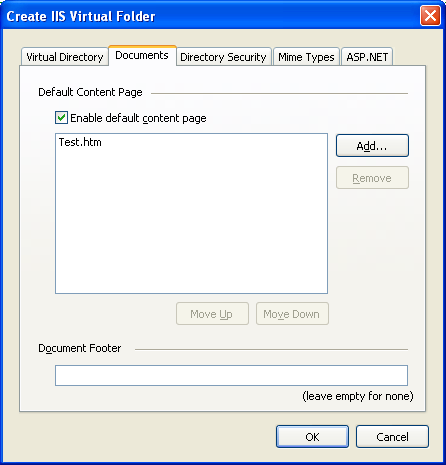

3. Possible BUG no 3: Setting the default document doesn't work.
If the bug no 1 occurs, the default documents section defined in "Create Virtual Directory" command is ignored.
Illustration to bugs 1-3

Thanks a lot for the well qualified report. It seems you've found some issues with IIS 7. I'll be reproducing and escalating to R&D.
It seems the core issue is to have a custom application installed first on the target system. Could you please provide step by step instructions of that also - so we have no issues reproducing the bug at our end?
Thanks!

It's easy to reproduce bugs no 1-3:
1. Take a Windows Server 2008 (R2)
2. Choose a Web Site that has at least one application
3. Execute the command:
The "TestFolder" virtual directory will be created in the wrong place. That's where all the problems start.

We have a fix for this issue, ready for you to test.
Again, thanks for a very well qualified report that made it easier for us to find the issue.
Please extract the attached archive onto:
C:\Program Files\InstallAware\InstallAware 9 R2\interop (typical installation path)
Be sure to backup the miastub.exe file inside that folder, as the archive extraction will overwrite that file.
Fully rebuild your project and please confirm that the fix is working for you.
Once you have confirmed this fix, we will take this fix live for all our licensed customers. At that point, just regenerate and reinstall your license for the fix to be officially installed.

Thank you for such a quick fix. I have tested your patch and it works!
1. Virtual directory is now installed in the correct location
2. The "Documents" tab is set up correctly
3. The folder is removed during the uninstallation.
