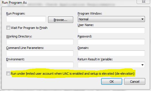

The only thing that I could think of off hand is that you may actually be using the Run Program As command with the option "Run under limited user accound when UAC is enabled and setup is elevated (de-elevation)" checked. Make sure that isn't checked...
