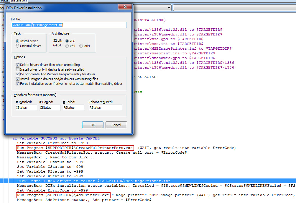

Could you post a screenshot of your DIFx dialog settings?

As requested is a screenshot of my DIFx settings and some other code around it. The highlighted lines are utilities that I need to run to create a "nul" port and the AddPrinter exectubale is something I cobbled together in C# that adds the printer. Without my AddPrinter executable the .inf file does not actually create the printer. If I run it via the Device and Printers control panel then it works. I'm convinced my AddPrinter is required as the same functionality is possibly implied/assumed when I run it through the control panel?
