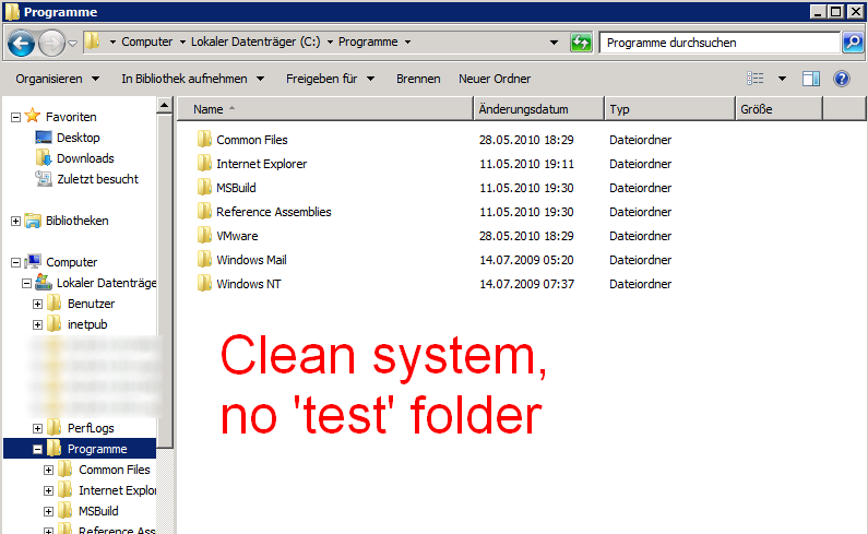

The test

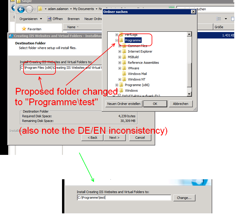

1. Start the installer
2. Go to the "destination" dialog
3. On the destination dialog the target folder proposal is set to "C:\Program Files (x86)\Creating IIS Websites and Virtual Folder". This should be correct (despite the fact, that it's the DE system and the 'Program Files' should be displayed as 'Programme'). The installer is running in the 32-bit compatibility mode, that's why the (x86).
4. Change the proposed target folder to "C:\Program Files\test". I know that the 'Program Files' (without x86) is not a standard path for 32-bit applications, but this is exactly what our customers are doing. Please note that in the "Browse for Folder" modal windows the folder name is "Programme", but after clicking on "OK" it is changed to "Program Files" in the "destination" dialog.
Changing the target folder
02 - changing the target folder.png (59 KiB) Viewed 11036 times
5. Proceed with the installation

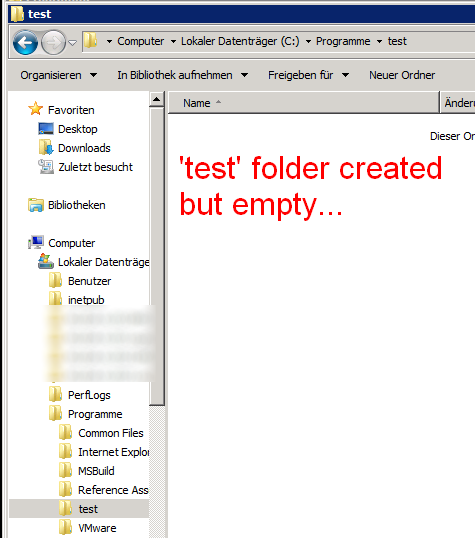

6. The results:
- The "C:\Program Files\test" folder was created, but it is empty
- The files were installed to the "C:\Program Files (x86)\test" instead...
Files missing
Files missing
03 - test folder created but files missing.png (32.53 KiB) Viewed 11036 times
I consider this as a bug. If the redirection was done, why wasn't I (as a user) warned about it? And why wasn't the path corrected in the "destination" dialog?

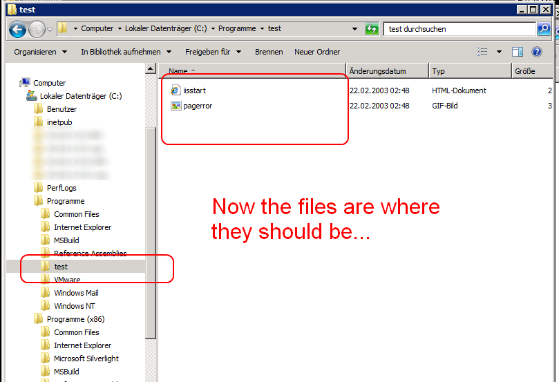

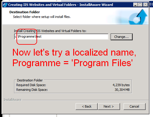

4. Change the proposed target folder to "C:\Programme\test"
Using the localized 'Program File' name
04 - using the localized program files name.png (21.86 KiB) Viewed 11035 times
6. The results: files copied where they should be:
Files copied
Files copied
05 - files copied properly.png (57.5 KiB) Viewed 11035 times
This is odd. I have tried to find some workaround and I couldn't find anything useful.
Best regards,
Adam

Post by adi »
What I meant was that it works when you use "Programme" and not "Program Files" in the path. In such cases the application is installed to the "Program Files" folder, and not redirected to the "Program Files (x86).
By localized folder names I mean the names displayed/managed by the operating system ("Programme"). It has nothing to do with the IA localization process.
Please let me know if you need some more information/clarification.
Best regards,
adi

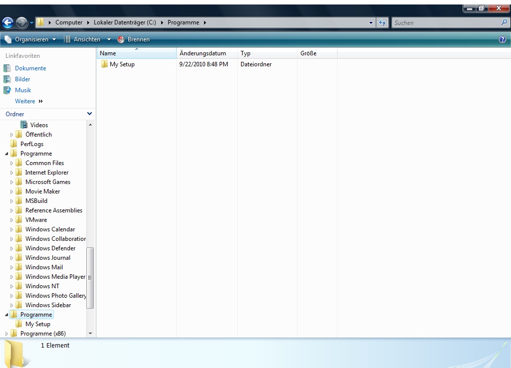

Re: Files not copied to the target folder on Windows 2008 R2
Post by mills »

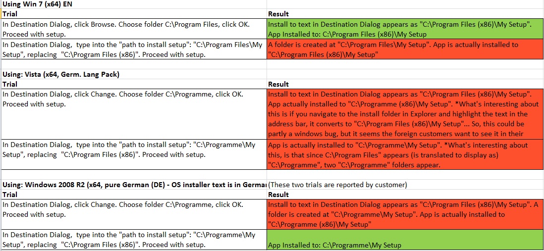

Check this out! Folder duplication:
But, that's not what you reported.
In this case, I was testing on Vista with German Language Pack applied.
In your case, are you working on a "pure" German OS? Meaning, everything including the installer is in German by default?
adi
Posts: 57
Joined: Mon Mar 22, 2010 8:28 am
Post by adi »
It looks like you have discovered a really nice "feature" ;)
I was working on a pure Windows 2008 R2 DE. The installer was compiled on a different machine and contains only the default (English) language.
In my case there is no folder duplication. The files are installed to the "real" Programme folder which is only for 64-bit applications. You can see that in the attached screenshot.
Best regards,
adi
Post by mills »
OK. I'm going to have to revisit this. I'm going to make a matrix of trials and results for English, English with German Language Pack and German, since it looks like the results are differing in all 3 cases. I'll need you to fill in or verify the pure German results.
Post by mills »
Below is my report. Please verify the accuracy of the two items you reported (at the bottom):

Posts: 57
Post by adi »
I confirm the results on Windows 2008 R2 DE.
