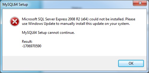

I’m running into problem installing the SQL Express 2008 R2 x64 bit runtime on a 64bit Win7 machine (Enterprise) and a 64 bit Windows Server 2008 R2 system. Both systems fail with the same error: “The operating system returned error 38(Reached the end of the file.) to SQL Server during a read at offset
0000000000000000 in file 'C:\Program Files\Microsoft SQL Server\MSSQL10_50.SQLEXPRESS\MSSQL\Template Data\MSDBData.mdf'.” (see attached file)
Sure enough when I checked the file size of MSDBData.mdf it is zero bytes in length. To verify that my install script changes we not causing problems, I created a test install that just installed the SQL Express 2008 R2 runtime. I've set the "Administrator privledges" and '64 bit OS.."

2010-09-19 15:30:48 SQLEngine: : Checking Engine checkpoint 'ConfigureServiceBroker'
2010-09-19 15:30:48 Slp: --SafeSqlCommand: ALTER DATABASE tempdb SET NEW_BROKER ALTER DATABASE msdb SET NEW_BROKER
2010-09-19 15:30:48 Slp: Sco: SqlException: Message:The operating system returned error 38(Reached the end of the file.) to SQL Server during a read at offset 0000000000000000 in file 'C:\Program Files\Microsoft SQL Server\MSSQL10_50.TATTOOSTUDIO\MSSQL\Template Data\MSDBData.mdf'. Additional messages in the SQL Server error log and system event log may provide more detail. This is a severe system-level error condition that threatens database integrity and must be corrected immediately. Complete a full database consistency check (DBCC CHECKDB). This error can be caused by many factors; for more information, see SQL Server Books Online.
Cannot create a new Service Broker in read-only database "msdb".
ALTER DATABASE statement failed.
LineNumber:1

Found the problem:
\sqlexpress2008r2bin_x64\x64\setup\sql_engine_core_inst_msi\pfiles\sqlservr\mssql.x\mssql\binn\template\msdbdata.mdf is 0 bytes.
Edit: Replaced the file in the web media block on my server, going to try the install again.
Edit: Yep. That fixed it. IA needs to update that package.
