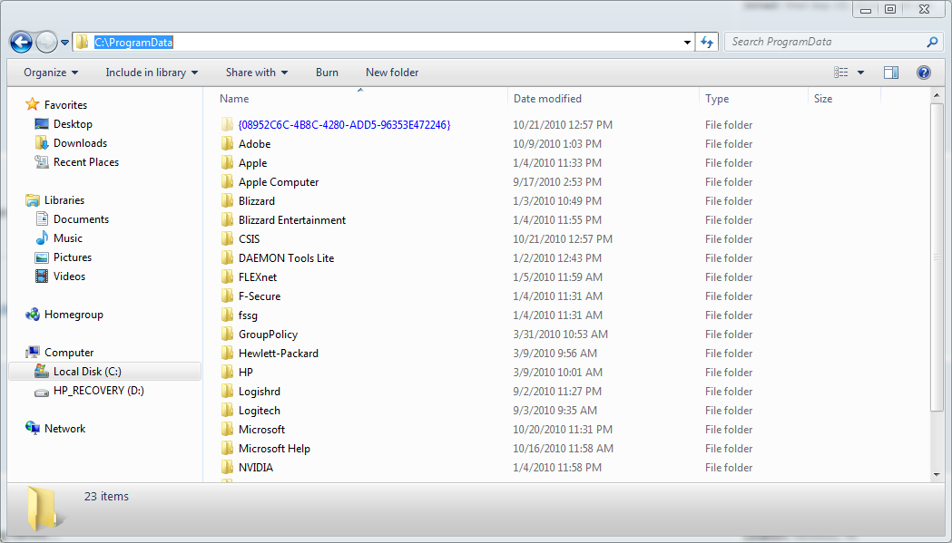

Can you post a screenshot? I just want to be sure what the folders are being named...
Re: Install aware creating a new {product code} folder
Here you go. Just ran an install on my machine... Restarted... and blue folder still there.

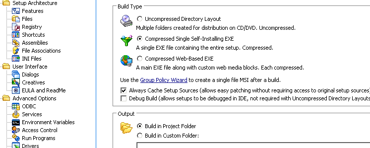

Are you using Web Deploy (build type)? This is not related to web updates.
The web builds are set to cache the setup data (this is particularly helpful if you plan on issuing patches).
You can check under the Build Settings under the Deployment folder of the design view.
There's also a check box for "Always cache setup sources". What is that set to (check, square or blank)?
Ok here are the settings...
- screen01.png (23.13 KiB) Viewed 8604 times
That's why it's creating the folder. It's caching the setup, so the user won't be prompted for sources during patches or maintenance (uninstall).
