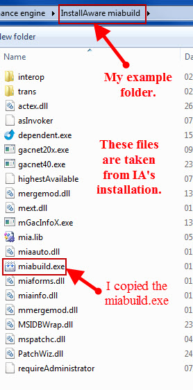

Andy,
My attached screenshot shows what I have. The folder I've highlighted is what I want to deploy on the developer machines. If I run miabuild from within that folder, like I want them to, I get the nag screens popping up even though I have the fully registered 9R2 installed on my machine. If run miabuild from Program Files\InstallAware\... I never get nag screens. It's this that makes me think I'm still missing something in what I need to put on their machines because I'm fully registered for IA on my own.
Is it the case do you think that I can't simply copy the folder I've listed onto their machines or must I install IA first? I'm reluctant to want to run the license file for obvious reasons. But if it means it eliminates the nag screens I'll do so. Obviously I want to push installations out of the door that don't have them and giving the other team members the ability to do the complete build process on their machines is better for continuity if I go on leave or take a day off when things start to go test-critical.
- Screenshot.jpg (74.45 KiB) Viewed 4952 times
