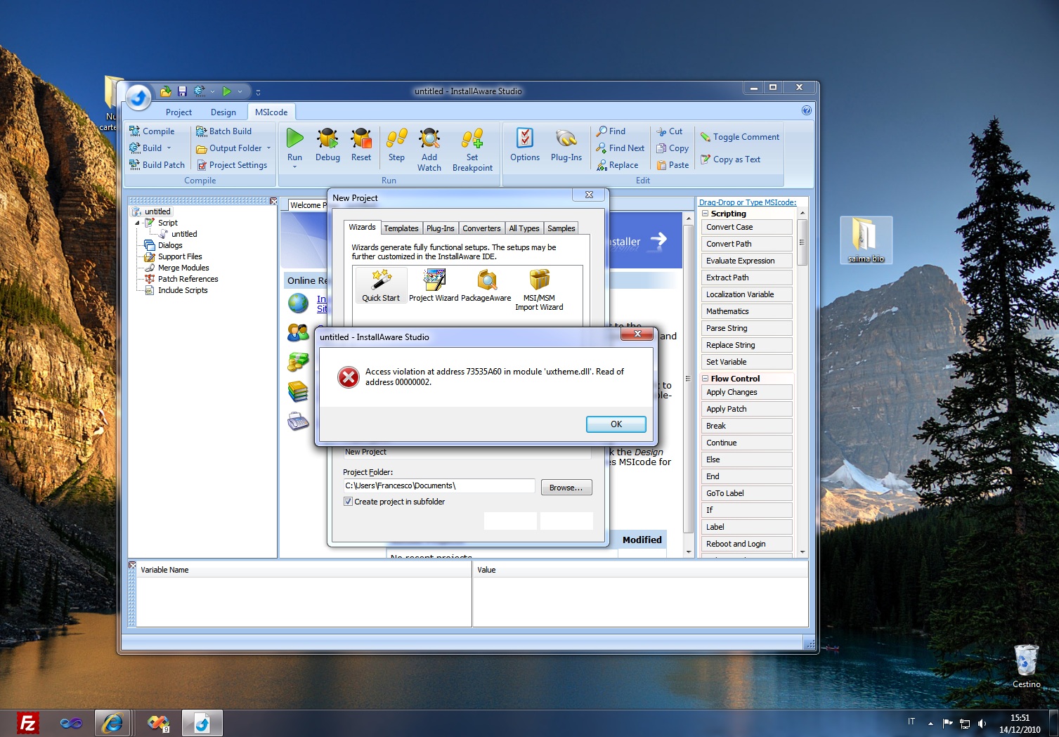

I have download (full install) and installed InstallAware 10.0.1 upgrade on my system (Win 7 Ultimate 64), but when the application is launched causes multiple Access Violation in module "uxtheme.dll".
By the moment I have reinstalled the prevoius version 10.0.0.
Attached you will find a screenshot png file.
InstalAware 10.0.1 Access Violation
- 10.0.1 Access Violation
- 10.0.1 access violation.jpg (491.07 KiB) Viewed 18738 times

We are currently investigating this.
Re: InstalAware 10.0.1 Access Violation
This issue has now been resolved. Please see the release notes for InstallAware 10.0.3.

This is now MOSTLY fixed. I have installed 10.0.3 and am running my custom theme and no longer get the access violation problem running my project. However, if I launch IA 10.0.3 and click on Quick Start on the Project tab, I get the access violation problem when the New Project dialog is displayed. Although I haven't thoroughly tested this version, I did test the Group Policy Wizard on my current project and it seems to now work ok.

Also received the access violation error running the Web Deploy function when the Build Progress dialog appears.
