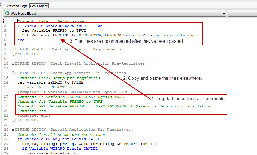

Aviv, I can replicate Nick's problem very easily. Create a new basic setup project and unfold all code regions. Select one of the "If" blocks at the top of the MSIcode script and use Toggle Comment to convert it into comments. Select the commented block and paste it elsewhere in the MSIcode script. Voila! The script uncomments the code! I don't think that's necessarily the correct thing for it to do?giaviv wrote:...Comments should remain as they were - they do for me!

Aviv,
I just tried it again to make sure I wasn't having a "psychodelic experience"
Attached screenshot shows the effect.
- Paste problem.jpg (219.8 KiB) Viewed 16451 times
