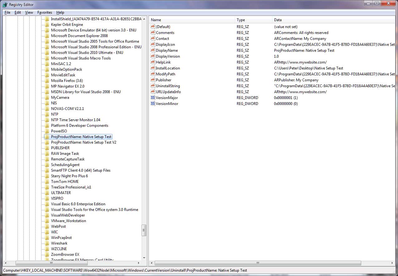

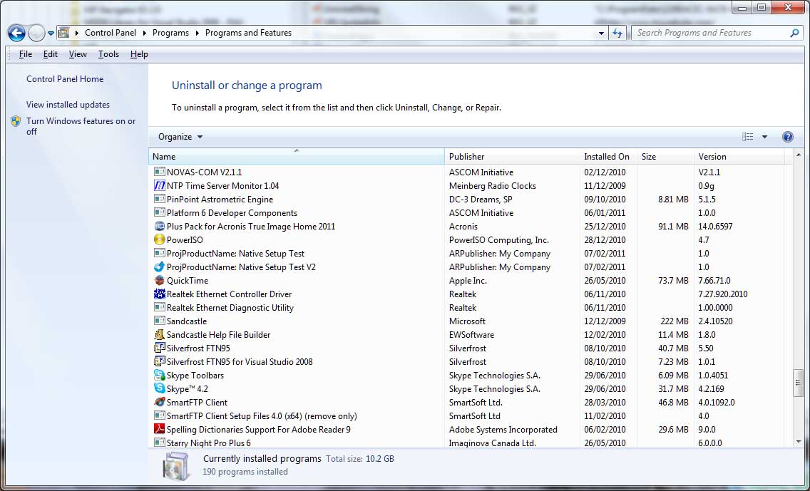

I downloaded the project to a new location on my Win64 machine. Build it without change and installed it successfully. This resulted in a new entry in the installed pprograms list called "ProjProductName:Native Setup Test". In the IA project I then changed the Product Name to "ProjProductName:Native Setup Test V2", recompiled and installed the new version. It successfully uninstalled the previous version but has left me with entries for "ProjProductName:Native Setup Test" and "ProjProductName:Native Setup Test V2" in the installed programs list.
I've attached images of the registry and program list so that you can see what I'm seeing. I noticed that the icon to the left of the program name for the first install has changed, presumably because the file providing the icon was uninstalled by the V2 installer.
For some reason, the uninstall registry entries of the first install are not removed when the upgrade is effected by the second installer.

- Registry entries
- Registry.jpg (127.85 KiB) Viewed 4136 times
- Uninstall program list
- ProgramList.jpg (100.25 KiB) Viewed 4136 times
