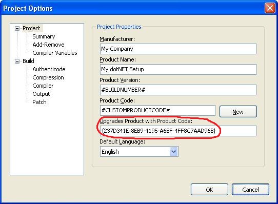

After a few more days and almost giving up I have found out in Orca that all 5 installers are using the same UpgradeCode!!! I came from Visual Studio Setup projects and there UpgradeCode uniquely identifies all version of one product - it must be different for different products! I searched documentation and forum and did not find any clue how to set UpgradeCode. Than just by chance I found the following:
The entered UpgradeCode is the code that is the same for all my products - as seen in Orca.

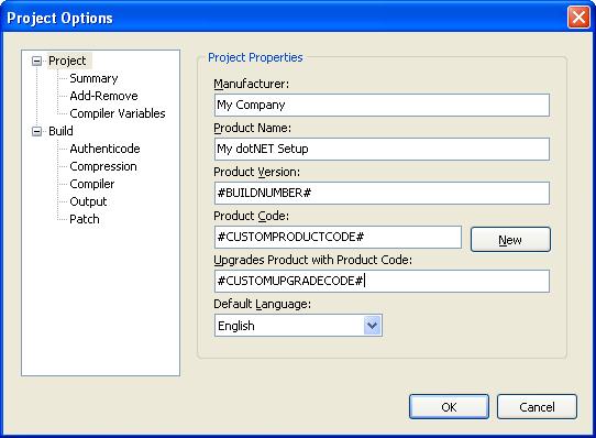

That was a breakthrough - after I have added a new compiler variable to specify UpgradeCode, the installers for all the product start to work.
This screenshot shows the final version of the settings:
This solution works for me. I hope it is the correct way of creating installers for different products and with similar user interface and licensing logic.
