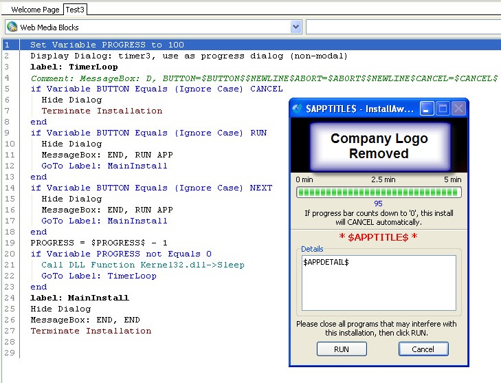

Hi, I've attached a sample code. As you can see from screen capture, our custom dialog states if a user does not select an action, it will cancel automatically.
I could get the countdown timer to work but I can not click on any buttons or they dont respond. Only when the countdown reaches 0 does it select a predetermined button. What we need is to have this dialog accept a user input (Run or Cancel) at anytime during the countdown. I know origin of the problem is the dialog is using "Non Modal" , I believe that means no buttons can be selected. Thinking that if I change it to "Modal", it will work. However, that breaks the countdown timer all together.
If you need any more details, please let me know.
- Script and Dialog
- SNAG-0758.jpg (134.09 KiB) Viewed 4409 times
