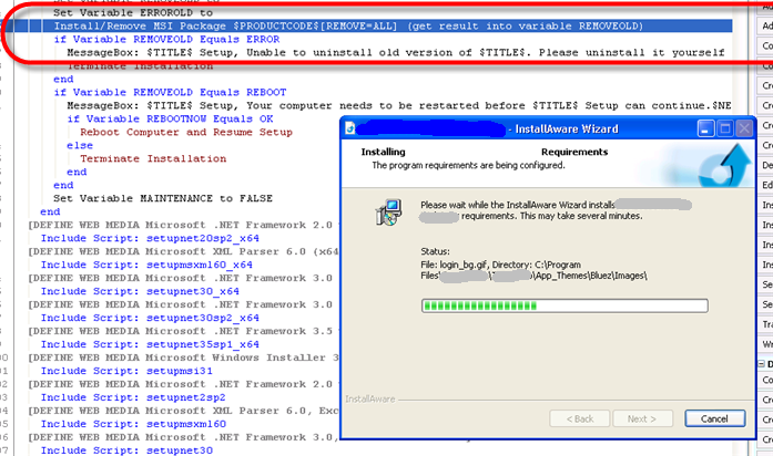

Re: IIS7 & Application Pools
Yep, really interesting indeed.
The PVU runs "Install/Remove MSI Package" whilst the "Remove" option in the maintenance dialog runs "ApplyUninstall".
One thing is 100% certain - the behaviour is -not- the same.
I think IA have to take a close look at this as it most probably is not the expected behaviour.
Another closely related issue is the fact that an Application Pool created by "Create Virtual Folder" never gets removed during uninstall (maybe an issue for a separate thread?)
