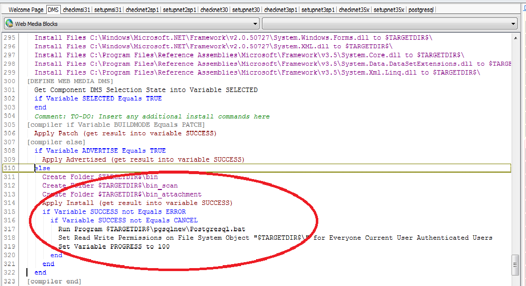

First i had add Batch file in to Run Program and set it to hide and then i had added Progress variable below the run program code in MSI Code. What i had write in MSI Code that is already pointed in attachment.
But it did not work.. Any suggestion ?
- page1.png (85.26 KiB) Viewed 11570 times

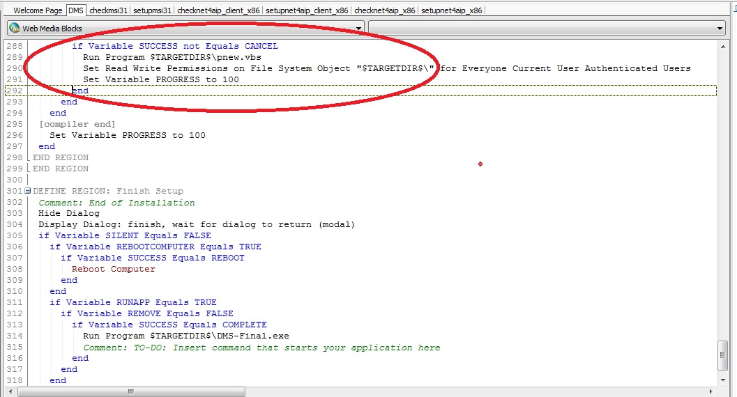

I used Install Aware version 11. Which codes comes after the code segment that can be mention in new attachment. If i run current code it displayed dialog with progressbar but problem is that progressbar had blanked and after my batchfile run successfully it appears finish dialog box without fill up progressbar of previous dialog.
-- Hiren Lad.
-- Hiren Lad.
- page2.png (68.28 KiB) Viewed 11564 times
