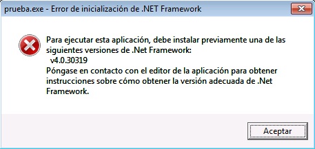

Launching the installation detects that you have to install the Framework Framework 4 and 4 Client Profile. It installs perfectly, but when you start the application displays the following error message.
Error
Error
In Windows XP works without problems, only happens to me in Windows 7 x86 and x64 Windows 7. In Windows Vista I have not tried.
If I install the original Framework 4 downloaded from the Microsoft website works perfectly.
What could I do? :(

How did you create the .NET 4 framework runtime?

I downloaded InstallAware 12 and copy de runtimes in the installation folder.
Thanks you.

Please try running the framework binary from the bin folder (net40_bin) manually on the machine.
Does that succeed? If not, it should give you some more information about the error.

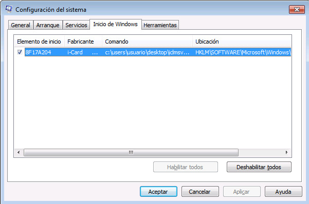

Yes, entering the line, because if I go to the registry key "HKEY_LOCAL_MACHINE\SOFTWARE\Microsoft\Windows\CurrentVersion\Run" appears the following key:
"8F17A204" c: \ users \ user \ desktop \ iclmsv ~ 1.exe / m = "C: \ Users \ user \ Desktop \ ICLMSV ~ 1.EXE" / k = ""
If I enter "msconfig" also appears in the following image:
But to restart the computer not start.

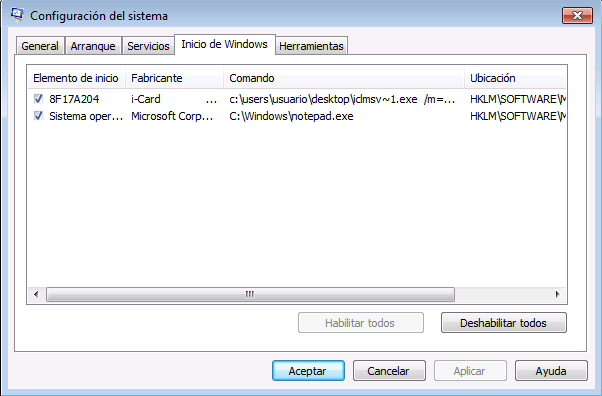

I made another test, I added is launched at start "notepad.exe" as in the picture below and it works but not InstallAware.
What could I do?
Thank you.
Rubén.

Are the any other differences you can see between the notepad running command and the IA one? Does running the IA command in CMD works?
gonpla
Posts: 40
Joined: Tue Sep 06, 2011 8:47 am
Re: Framework 4 runtime does not install correctly
Post by gonpla »
I forgot, in Windows XP works perfectly, it is only in Windows 7.
I just try to run the command from CMD and working properly. Do not understand why you do not launch automatically at Windows startup.
Rubén.

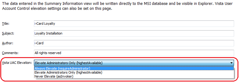

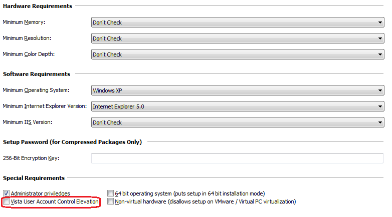

I've found the problem, but do not know how to fix it.
If I have activated Windows 7 UAC does not work. I tried to disable it and it worked properly.
I do not know if there is any way to put parameters on the command that saves InstallAware to run with privileges to restart.
In "Summary Information" on "Vista UAC Elevation" I have checked the option "Elevate Administrators Only (highest Available)". I tried to change it to "Always Elevate (requireAdministrator)"
In application requirements, also have tried to mark the "Vista User Account Control Elevation".
Neither have worked. I do not know what else I can do. I have Install Aware 8, do not know if this will be corrected in Install Aware 12 ...
