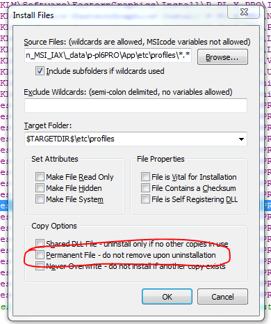

You can find it in the options of the "install Files" command. Just double klick on the InstallFiles line in the MSICode-View.
- install-files.PNG (54.58 KiB) Viewed 16228 times

Thanks, I still don't see how was supposed to figure this out. Why not simply allow straight text editing? And the help / how-to's could definately be more informative...
Anyway, be that as it may, finally getting there...
Still... I need to add 2.300 files from 8 folders with various exentension, I'm not seeing any way to add folders and subfolders with one command, the file open only allows me to select files.

If I understood right, thenI would recommend insert "Install Files" 8 times, each for every folder and select "include subfolders" as you can see in my picture above.I need to add 2.300 files from 8 folders with various exentension, I'm not seeing any way to add folders and subfolders

That would be fine if dialog did allow me to select folders, instead of only files.
Is there really no way to edit the script manually?
