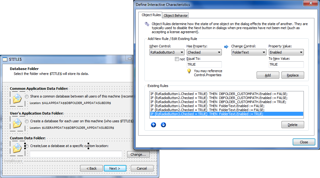

I've made a custom dialog with 3 radio controls on it. These correctly bind to underlying script variables and I can detect them correctly in my code.
However, whilst the dialog is visible I want to enable/disable certain other controls on the dialog according to which radio button is selected. Specifically I want to enable an edit box and browse button when the third radio button is chosen.
I'm fairly sure I should be able to accomplish this using the object rules settings for the dialog. I added rules for each RadioButton.Checked proptery to set the various other control.Enabled to True/False but it doesn't work.
The problem is the radio buttons don't ever seem to be marked as 'Checked'. I've tried Checked = TRUE, Checked = True and Checked = 1. Am I missing something obvious?
Attached is a screenshot of my dialog and rule behaviours.

- Screenshot of my dialog and rule behaviours
- IA-RadioEnabled.png (103.82 KiB) Viewed 7817 times

The problem is that the Checked value of a radiobutton / checkbox only gets set when the dialog returns - it doesn't change during the time the dialog is displayed. What you are trying to do is not possible unfortunately.
