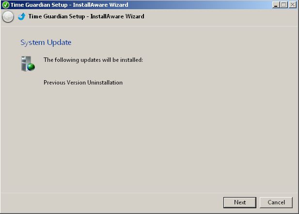

So if I do the following:
1) Build and deployed a web setup and then installed onto a number of PCs.
2) Rebuild the installer files and upload on to web server.
3) When a user reruns the setup program InstallAware wants to uninstall first, see attached.
How do I stop this and simply install over the top?
Second question, if the program is running it still seems to uninstall without a reboot - why?
Thanks for your help.
Dennis.

Re: How to Stop Uninstall from Running?
This is part of
the installation script (old version removal). The reasons for the old
version removal are non-trivial, they cannot be worked around in Windows
Installer unless a patch is being applied; but the native engine is far more
forgiving and will not suffer from this limitation.
The removal of the previous version before installing the new one is a part of the setup script (inserted by the template you used).
The reasons for the old versions removal are non-trivial - they cannot be worked around in Windows Installer unless a patch is being applied; but the native engine is far more forgiving and will not suffer from this limitation. You can turn on the native engine by setting the variable NATIVE_ENGINE to TRUE).
That may help - how do I do that?
Also, as part of the uninstall runs a post uninstall script - can this be stopped?
I'm usung InstallAware 12.
The post uninstall script is actually a VB.NET prpogram that does some database work after the uninstall is completed. So when they dust do a reinstall I do not want this program to run.

You can, in your MSIcode, check if MAINTENANCE is TRUE - if it is, that means that the setup has already been installed.
tThanks, this is what I'm after.
