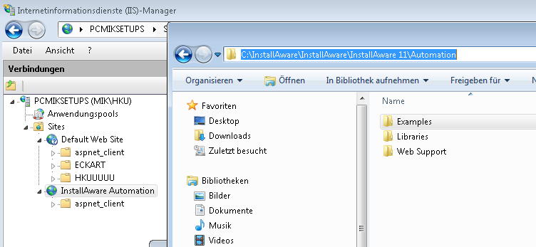

I installed this option and in my IIS I have this "Automation Site". I tried on 6 machines...
There is no helpfile available how to configure a project to use this with this automation tool.
So what do I have to do...I spent hours over hours...no solution !
THANKS !!!

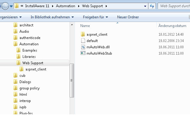

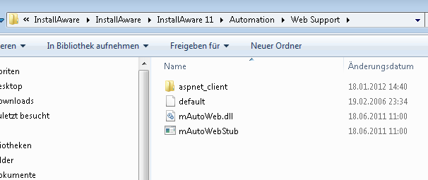

The helpfile does not explain how to SET up...or I have the wrong file. Maybe you can explain how to set it up.
I have only 3 files in this directory. How can I automate my setup projects ???
png-ile attached
png-ile attached

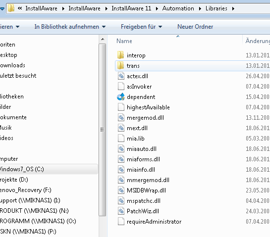

Hello Guys, it is not working.
I get the following messagebox that miaauto.dll is not on my computer...BUT THIS FILE EXISTS in the Library.
And i installed everything possible !!!
Where do I have to copy this file to ?? Where is the file needed ?

Re: Build via Webpage???
Dear Mik,
the "miaauto.dll" must be placed in the same directory of your calling executable to work (as described in IA documentation).
For your test purpose, it is available a sample delphi test application in the install folder: "Automation\\Example".
An executable for this application is already compiled and available in the above installation folder, so with this you should be able to perform any test.
This application use "miaauto.dll" to work and if the dll it is not placed in the same exe directory, you will receive an error for DLL NOT FOUND.
hope this helps you.

I cant find the documentation for automation. f1 does not help. please send me a documentation for that
So please read carefully..I think we have a very BIG misunderstanding...
1. I have a normal .NET project on D:\Setup\project\softwarename2. Usually I start this by build via miabuild.exe in CMD or IA GUI on my SETUPMACHINE
3. NOW I want to start the buildprocess via another computer in my company
4. WHERE do I have to copy my projectfolder to and what is with the library folder and the web support folder?
I cant use this because I dont know where to copy and what components I need and what LINK do I have to open in my browser...
Please help me, my boss is very angry at me because IT DOES NOT WORK..so please please please help me really
Here are my current folders in Automation folder
