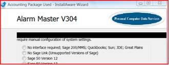

I am currently building an installation script in InstallAware Studio 2012, and my boss tested it at home. He reports:-
"Big Black Bar across many dialogs i.e. Select Installation location"
I have never had Big Black Bars across any dialogs and don't know what to do about this. Has anybody experienced this problem and what is the solution?

Hi Francesco and Peter
I have belatedly got hold of screenshots of the big black bars that appear on dialogs when my boss runs an InstallAware script. These screenshots are attached. I can assure you the bars are not part of the dialog designs.
Any thoughts as to why this is happening and what we can do to fix it?

Re: Big Black Bars
Dear Martin,
I seen your screenshots and honestly ... I do not know?
It is very strange ... the the only possible thing that comes to my mind, it could be a problem with the video card of that PC.
If this happens with a particular PC only.
Re: Big Black Bars
Martin,
Does it always happen when your boss runs the installer on his machine? If it does happen consistently or say 90% of the time, could you consider changing the screen resolution on his machine and repeating the installation a number of times to see if there is a repeatable outcome.
Those black bars look very much like the ones I see when I run VS. I inherited a much faster machine and I get that problem occuring now and it never happened on the old machine I have sitting next to me on my desk. I'm still inclined to think it's environmental.
I did notice something a few weeks ago. I have SnagIt installed. It records the screen contents. When I recorded a support problem I was having in VS' IDE, I recorded the project interaction and not once in the recording session did I get a problem. Once I stopped recording the black content came back and I recorded well over an hours-worth of screen content. I wonder then, if SnagIt's 15+ frames per second capture might have "slowed" the graphics or refresh rate down to the point where it wobbled into good conduct. Just an idea...

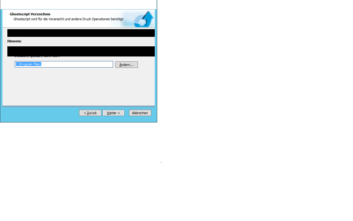

I have the same issue when I execute my setup on a Server 2012 system.
This black bars appears only on two dialogs which I made new.
No problems with this setup on Windows 7 and Server 2008 R2
any ideas?

Re: Big Black Bars
Dear Hans,
it is not necessary to delete the Vista Glass control, just turn it OFF by setting the "GlassEnabled" property to FALSE.
The Aero Glass theme first introduced in Windows Vista and enhanced in Windows 7, has been abandoned for Windows 8 & Windows Server 2012 to improve the overall performance of Windows and energy efficiency.
With the last IA major release ( IA 15 natively supports WIN 8 & WIN SERV 2012 ) have been introduced several modifications with the dialog's routines to improve draw functionalities and possible Areo theme conflicts with the more recent OSes.
Re: Big Black Bars
Dear Francesco
thank you for help.
<<it is not necessary to delete the Vista Glass control, just turn it OFF by setting the "GlassEnabled" property to FALSE.
Where can I find this setting? In the Dialog?
But why are the black bars only on two dialogs and not at all?
I have not IA15, I work with IA11
kind regards
Hans
