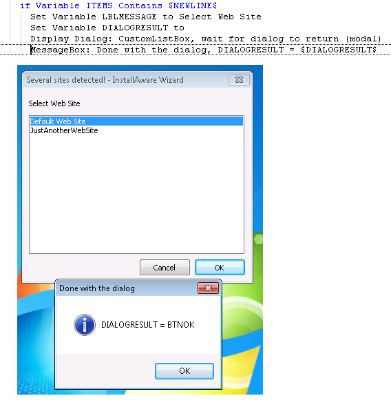

Unfortunately this doesn't work. 'Hide Dialog' only hides non-modal dialogs and mine is a modal one (letting the user select an option before continuing).
Just for testing I inserted a messagebox after the dialog is expected to close, see attached image.
The image shows both the dialog and the messagebox. Note that the messagebox also shows the dialogresult (the pressed button in this case).
Surely the dialog must be considered out of scope and should have been closed when the messagebox is shown?

Re: Modal dialog doesn't close on [OK]
Post by FrancescoT »
Dear Bjarne,
why do you not use a similar behaviour in your script?
As example: After the welcome dialog, I used a progress dialog (non-Modal) that update the status for supposed actions. When completed I used a dialog box and then the script flow continues.
Label: Welcome Dialog
Display Dialog: welcome, wait for dialog to return (modal)
if Variable WIZARD Equals CANCEL
GoTo Label: Main Install
end
Comment: Display a progress dialog as non-Modal
Display Dialog: progress, use as progress dialog (non-modal)
Comment: Execute some action
MessageBox: Debug, Test
Hide Dialog
Of course you could use a customized progress dialog to proper display your actions.
