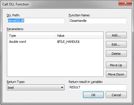

Hi. I've tried the new code. For some reason, the $FILE_HANDLE$ shows 0 even though it was declared. Once it ran, the $RESULT$ showed as FALSE. Is the code correct? I thought function is suppose to be GetFileSize to get the size of a file, not CloseHandle.
I've included screen capture of Call DLL function and all codes pertaining to this task. Thanks for helping in advance.
Here's my current code:
Set Variable FILE_HANDLE to $WINDIR$\System32\msiexec.exe
Call DLL Function Kernel32.dll->CloseHandle (get result into variable RESULT)
MessageBox: DEBUG, HANDLE = $FILE_HANDLE$$NEWLINE$RESULT = $RESULT$
Here's the contents of the CALL DLL FUNCTION:

- Screen capture of Call DLL fuction
- SNAG-0039.jpg (34.68 KiB) Viewed 9467 times

please review my code once again ... what you are doing is not correct at all.
FILE_HANDLE points to a file handle pointer (with WIN API is declared as HANDLE) not to the file name.
With my code the file name is passed as first parameter in CreateFileA WIN API function.
So just replace the file name I used with my sample and leave all the rest as it is.
The call to CloseHandle is required because it is necessary to FREE the pointer returned (FILE_HANDLE ) ... otherwise could cause problems.
To use my code just copy and then paste it in your script.
The sample will show a dialog that reports the size of the given file.
I have personally tested it!
