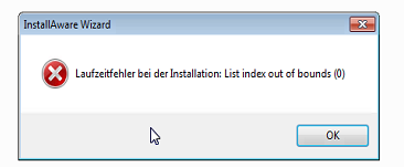

on a customers computer a setup crashed after apply install. Now he cannot execute any setup version of this product. The problem is the single instance check. If I remove it I can execute setups again. The error message is: runtime error: List index out of bounds (0)
Now my question: how can I clean the system that I can run again setups of this product with SINGLEINSTANCE=TRUE. I think there must be a file or a registry key that prevents setup from beeing started. What have I to delete?

- run time error in setup
- pl6pro_crash.PNG (13.92 KiB) Viewed 10805 times

I already found out myself that a file $TempDir$\{[RevisionCode]}.mia acts like a mutex file, if I delete it I can start a setup with SINGLEINSTANCE=TRUE twice. But on the relevant computer there was no {*}.mia file in the Temp folder, so is there another way IA checks the Single Instance? I just want to understand the process. Maybe I was in the wrong user-folder, so can you tell me if the named mutex-file is the only mechanism for single instance check?

They have confirmed that %TEMPDIR% is the only place used to store single instance check.

It is hard to reproduce because within my setup I call a 3rd party driver installation .exe (after ApplyInstall). This driver installation crashed on a customer PC (to BlueScreen!) and so the Single instance was still active (anywhere). The problem is that I am not able to force this driver installation to crash with BlueScreen on any Test-PC. I suppose it has to do with the speciality of the customer system (domain controlled etc.). So I think you will also not be able to reproduce it within my project (I am even not able to reproduce it if I terminate the installation via Taskman after apply install).

Actually, is the TEMPDIR\mutex-file check and the workaround for now is to clear the contents of the %TMP% folder. This should have been solved with the next IA release.
