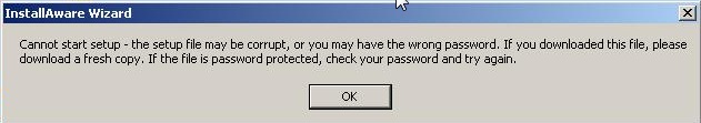

We have a client that tries to install the installer on his Windows XP SP3 machine but gets an error (see attached).
It happens on all of his XP machines.
Any ideas?
Regards,
T.
Setup error
Setup error
- install-error.jpg (24.7 KiB) Viewed 10035 times

Re: Setup error
Dear Tzachk,
For what I see the setup package seems corrupted ... please verify if any antivirus ( ... some are very intrusive) is causing the issue.

Re: Setup error
Hi Francesco,
The problem mentioned was indeed due to McAfee A.V. See event viewer below:
Event Type: Information
Event Source: McLogEvent
Event Category: None
Event ID: 257
Date: 01/11/2012
Time: 13:01:39
User: NT AUTHORITY\SYSTEM
Computer: XXXXXXXXXX
Description:
Blocked by access protection rule. Access to object C:\DOCUME~1\xxxxxxxxx\LOCALS~1\Temp\miaC4C.tmp\data\Microsoft Windows Installer 3.0\mWinRun.dll\ansi\usp10.dll was blocked by rule User-defined Rules:pws-yunsip.
The client told us that they suffered from the usp10.dll virus. Using google I found the following http://www.ehow.com/info_12085839_usp10dll-virus.html
I don't know if there is something that you can do to help in this case, but do note that this file is the root cause for installer failing.
In our case we disabled the A.V for the duration of the installation.
Regards,
T.
Event ID: 257
Date: 01/11/2012
Time: 13:01:39
Description:
Regards,
T.
