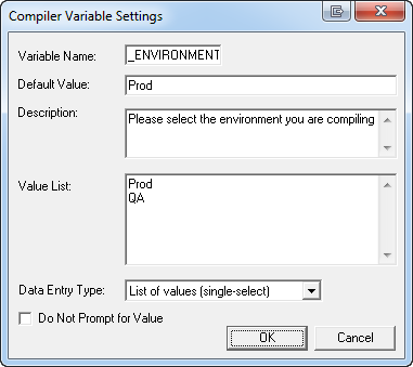

We are a Wise shop and are evaulating InstallAware. I have a question with Compile Variables and wondering if someone can assist.

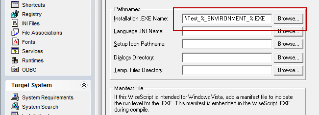

In Wise we add the following entries in the "Compiler Variables" section.
In the "Build Settings", we type the following entry in the "Installation .EXE Name" section.

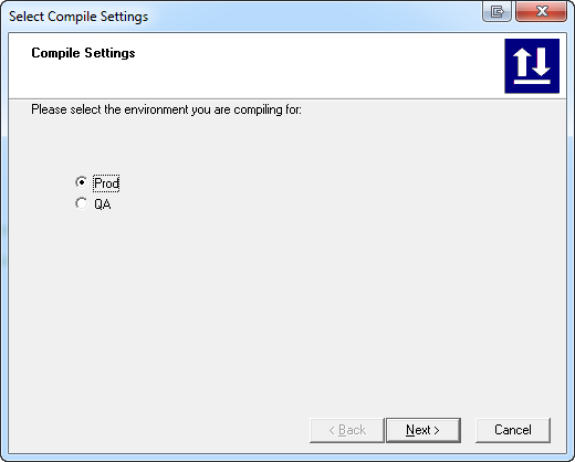

When we click the 'Compile' button, we are presented with the following message box.
Wise creates an EXE with the name Test_QA.EXE or Test_Prod.EXE
How do I do the same thing in InstallAware using Native Engine or MSI?
