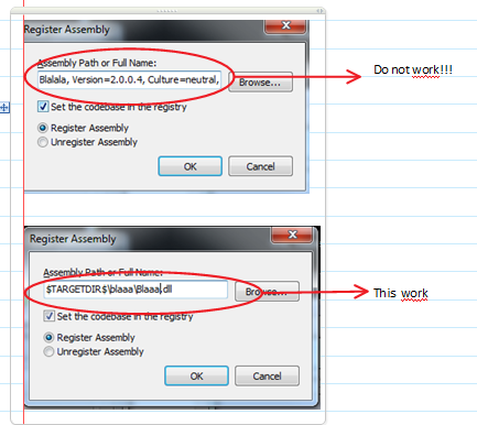

We have problem to write settings from a .dll to Registry using "Register/Install assembly". :(
It do not work, no Settings are written down...
This could be testet on XP or win7 (64)...
When we run it in Dos-BOX using "C:\Windows\Microsoft.NET\Framework\v4.0.30319\RegAsm.exe" we have no Problem..
When we run above RegAsm.exe with "Run Program" in IA 15 (Build 11.05.12) everything is fine...
What to do? You have an idea?

----does it happen with that assembly only, or with any other one?---
IT seems there are Register-Problems with other assemblies too..
Regasm.exe with "run Program" works fine!!!

Are you using "Set x64 - Native 64 bit Windows, .... installation mode" command within your code?
I'm asking this because I seen you used the x86 version of "RegAsm.exe" when you used the CMD prompt.

I think I got it, but it seems to be a little bit strang to me... :o
First... Using regasm.exe 64 or 32 bit made no difference!!! Both work fine...
1) (32-bit mode) I install the .dll using "install assembly D:\....\bla bla\ File.dll" before apply install :cry:
Result no registry settings are written...
2) Then I try to register using "register assembly D:\....\bla bla\ File.dll" after apply install using native engine...
I find out ...
what is going wrong with the first Version I tried?? Could You prove it? :?

with your screen shots you have two calls to Register Assambly and with it you should pass the file name only.
I am not a .NET expert, but for what I know the Register assembly command relies on "regasm" tool and with it the assembly have to be registered as;
- regasm myTest.dll
