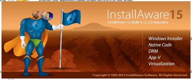

Yes, you are correct.FrancescoT wrote: To summarize, you have downloaded and installed the current IA version available (IA 15.51) and to activate the product you used a regenerated personal license file. am I correct?
IA 15 (Build 4.13.13) Naquadria. Please find screenshot attached.FrancescoT wrote: Could you please post wich is actually the InstallAware build number reported by IA IDE?
To visualize it, switch to "Project View" from IA IDE Ribbon Tab and then select the Version Button.
Regards,
Alex
- IA_Version.png (110.72 KiB) Viewed 29985 times
