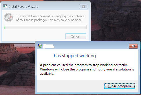

I have put a message box into the first line of the code as you suggested and it does NOT fire. (great suggestion tho)
This is the first dialog box to open. You can see in the attached image that the installaware wizard has just barely started to load and it crashes.
I've shut down everything i can find, I had some notion that perhaps its unpacking a 32 bit program on a 64 bit machine, but i pulled that out and it still crashes.
Any clue what else could be going on?
TIA
- Stopped working error message
- stopped working.png (105.66 KiB) Viewed 4982 times
