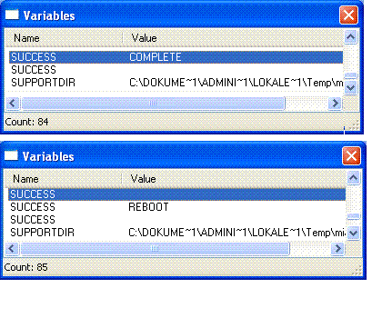

my setup started to show a strange behaviour. Sometimes the final page does'nt show the run check box.
I narrowed this down using Casic's runtime debug plugin. The problem seems to be a multiplication
of the variable SUCCESS if and only if the Install MSI plugin is used.
This happens if the Install MSI is used to install a pre requisite or to uninstall a previous version.
The problem is related to the thread http://www.installaware.com/forum/viewtopic.php?t=997.
The debugger shows a dummy SUCCESS value after (Un)Install MSI and runtime debug shows 2 variables SUCCESS!.
Every write access to SUCCESS creates a further copy. I have attached a screenshot.
The upper shows the situation after apply install. The lower shows the situation after I set SUCCESS to Reboot.
This is an absolute showstopper for my setup project. Please help and FIX this ASAP! :cry:

you're right - Install MSI doesn't duplicate SUCCESS by itself. Maybe I was not clear enough.
The problem is the combination of Install MSI followed by Apply Install later.
Actually the problem happens with Apply Install but only if a Install MSI was first.
Yes, Install MSI doesn't use SUCCESS but anyway it happens. I have not modified this and I have
no undefined variables. Have a look at the attached screen shot. How can it be?

The incorrect values for SUCCESS have been identified as a problem in the variable watches window - and not the script execution engine.
If you add a MessageBox to print $SUCCESS$, you will see that it displays $SUCCESS$ when $SUCCESS$ has not been defined yet (whereas, the variable watches window might display an incorrect value).
Your scripts should run correctly and will not be affected by this problem. This issue only affects the variable watches window and will be resolved in the upcoming update.
Also, I can only conclude that the runtime debug plug-in suffers from the same problem.

I could reproduce the behaviour and therefor I developed a new plugin to dump out the contents of the variables string (which the plugin receives from InstallAware). I attached the dump to this post. As you can see, there are 3 variables with the name SUCCESS. This works as long as the Runtime Debug plug-in is not used because the plug-in splits all variables into an internal field and sorts this field by the name of the variables. After closing the dialog, all variables are joined to an string and passed back to InstallAware. Depending on the sort function, it can happen, that one of the last variables (which are all empty) is now the first variable in the string. InstallAware uses only the first variable which matches the name -> so a different result may occur. Finally, this behaviour is no bug of the Runtime Debug plug-in because it uses only the data received from InstallAware.
