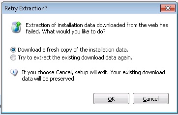

Re: Installaware - Auto updates
Dear Francesco,
I have downloaded IA 18 (trial mode) and checking the auto update feature.
- I have created main build (Ver 1.0.0) and installed in testing machine, its working. i have configured the scheduler for the updates through the IA.
- Copy the same build project (IA main build project) for patch (Ver 1.0.1) creation and configure the auto update features.
- when i login to the test machine its pop-up the update details and update the patch files in the test machine, its working.
- Copy the same build project (IA patch project) for next full build (Ver 1.1.0) creation and configure the auto update features.
- when i login to the test machine its pop-up the update details and shows Previous version uninstalling once completed the uninstallation start the new version (1.1.0) while installing shows the error message "downloading from the web has faild" refer the attached screen shot.
Please note, new version (1.1.0) files are places the same folder level of patch files.

Please suggest the solution for this
Please suggest the solution for this issue.
Dear Ravz,
I really suppose that the problem you are having, it has nothing to do with the WEB UPDATE process itself.
Instead, it is caused by the WEB MEDIA BLOCK used by your installer.
Try to rebuild all of them and then test the installer once again.
