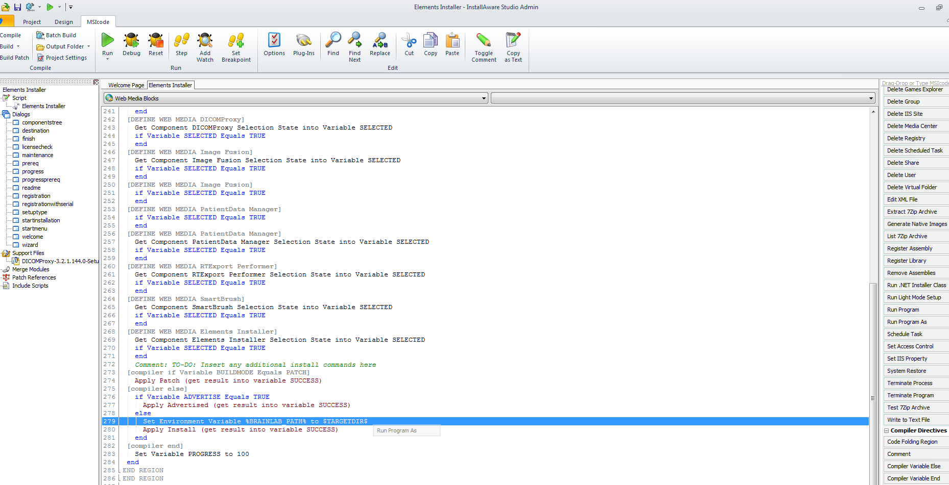

I am about getting familiar with MSIcode, respectively its code generator, though it seems to be working little inconsistent.
Even though I drag a "Run Program As" command all the time a "Run Program" command is _being_ dropped !
Please see pictures attached, which depicts "Run Program..." as source code.
Why is that ?

- "Run Program" as command inserted
- RunProgram.png (19.47 KiB) Viewed 11793 times
- "Run Program As" command is being draged
- RunProgramAs.png (180.62 KiB) Viewed 11793 times
Re: Run Program instead of Run Program As
Dear Tommy,
if you enter a value for "User Name" with <Run Program As> command ... you will have "Run Program As" correctly spelled in your code.
Anyway, I will log a note to our dev team in order to fix what you reported.

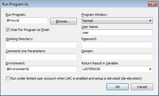

However Run Program As does not work if define an environment variable in the environment field. Why ?
This program launch ends with error code -11.
Regards,
Tommy
The parameters are correct and my program launch works well with those parameters, which is called by "Run Program"
Set Variable Proxy to $SUPPORTDIR$Proxy-3.2.1.144.0-Setup.exe
Set Variable Environment to PATH=$TARGETDIR$
Run Program as User \user: $Proxy$ (WAIT, get result into variable LASTERROR)

- Run Program As dialog
- Untitled.png (14.42 KiB) Viewed 11747 times
Dear Tommy,
this happens "very probably", because the environment variable you are setting, in reality it is not available when you call the Run Program As command.
For what I see by the code you posted;
1- The "Set Variable Environment" is a Windows Installer command (Purple command) and due of this and unless you use IA Native Engine, the command execution is deferred until the Apply statement is run.
http://www.installaware.com/forum/viewtopic.php?f=2&t=4338
2- You can change environment variables at any time. However, this will only change the environment block for new processes executed after the change. Existing processes will keep on using their current environment block, which is the same as it was before you made the change.
New processes only will inherit the changed environment.
